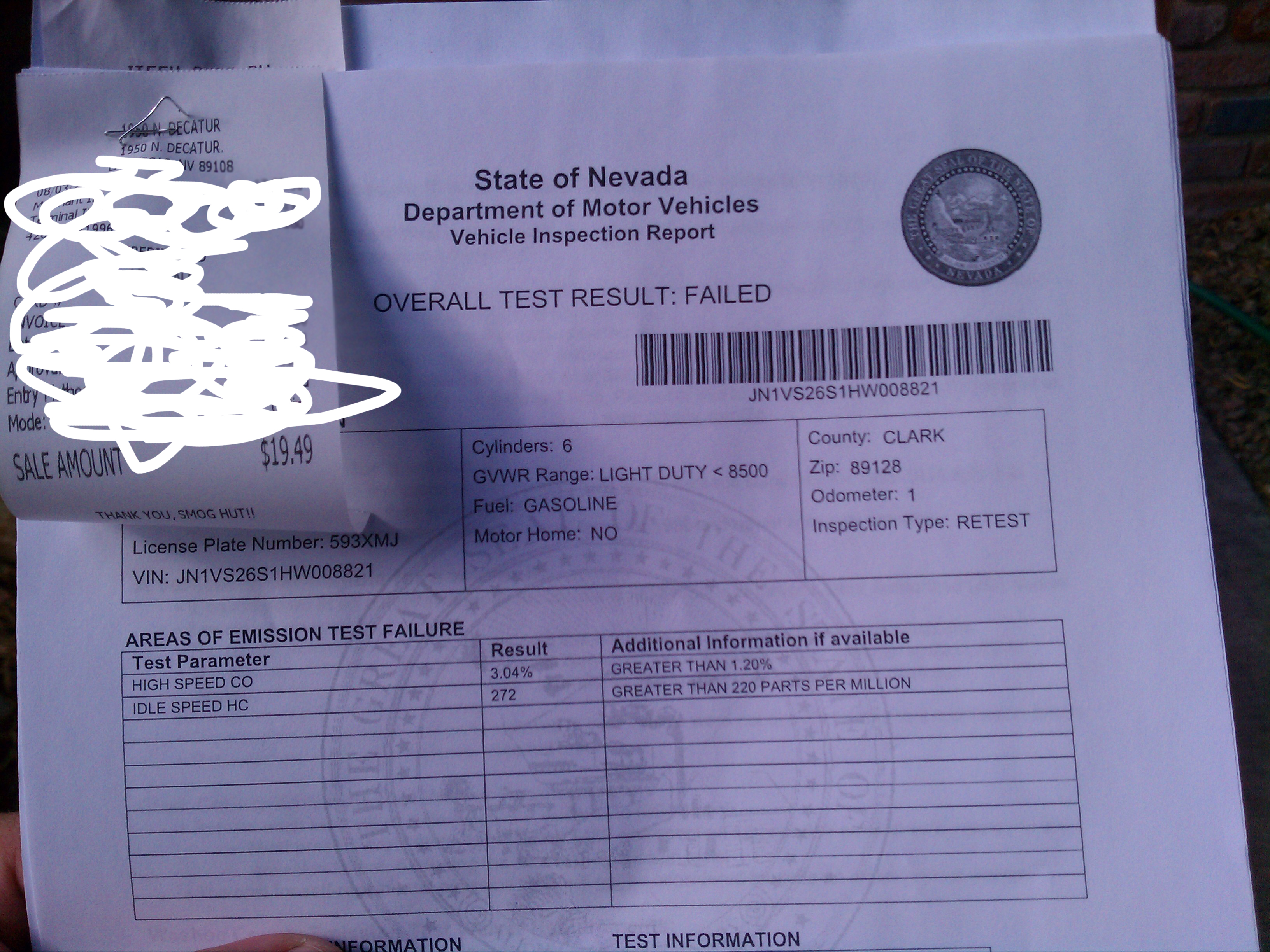

I am having a bit of troubles here.
I am really stumped, How can I fix this? could the z31 ecu and 86 z31 maf cause this?

I drove it 30 minutes in the heat of the day, with launching at almost every stop light before I got there.  From work to the place of smog, still a failure.
Today's high is 104, and with some high humidity.

Idle Speed CO  2.44% Greater than 1.20%
High Speed CO 3.54% greater than 1.20%
Idle Speed HC 286 great than 220 parts per million.
No smoke, no gas dripping. No emission smelling either.
But I guess my roomy's notice when I take off it puffs but after all the crap tonight not 1 puff, not even 1 smell from the exhaust pipe.

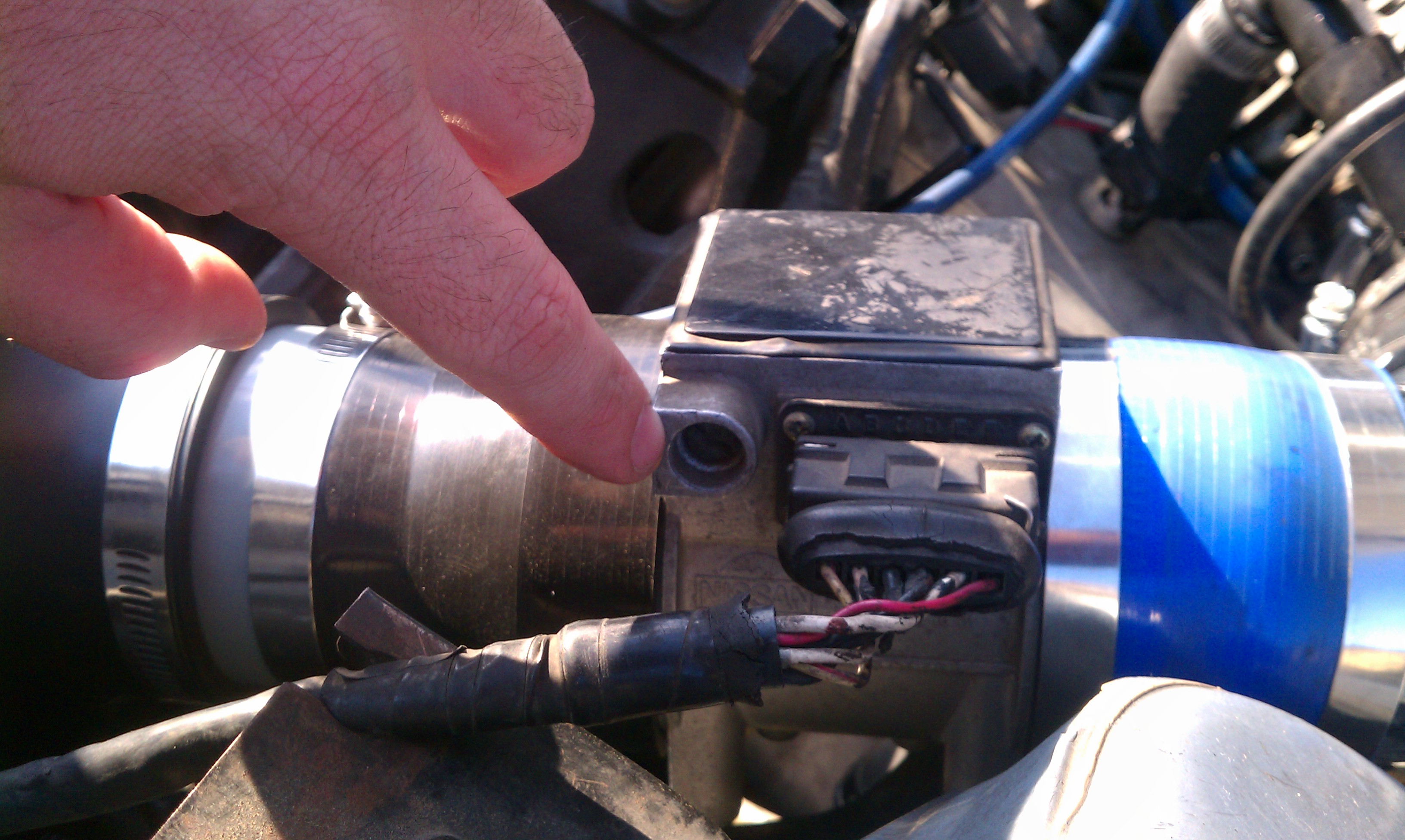

Even with everything done so far it still failed.
Something I didn't know but I had to close up the screw on the 86 z31 MAF, and did alot of turning and fine tuning to get the numbers low.  With this tuned down, it still felt fast and still have to test it on the gas millage but I think my MPG will increase from 10mpg lol.
