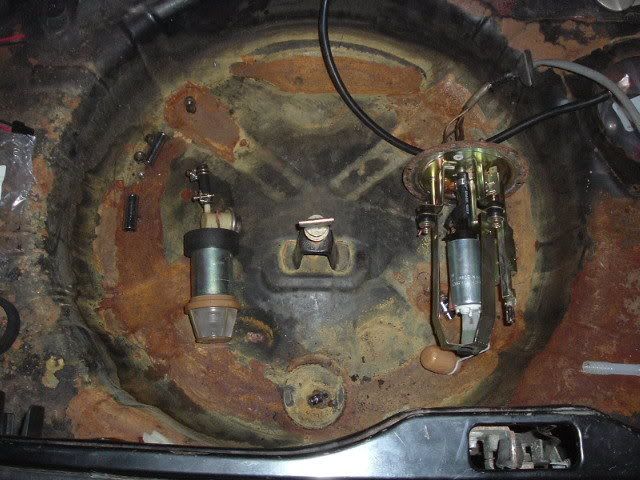

Fuel pumps. Walbro is sitting inside cage (not tied down yet), S12 is on left. As you can see, the trunk had water sitting in it and has lots of surface rust.. Nothing a brillo pad + tremclad cant fix.

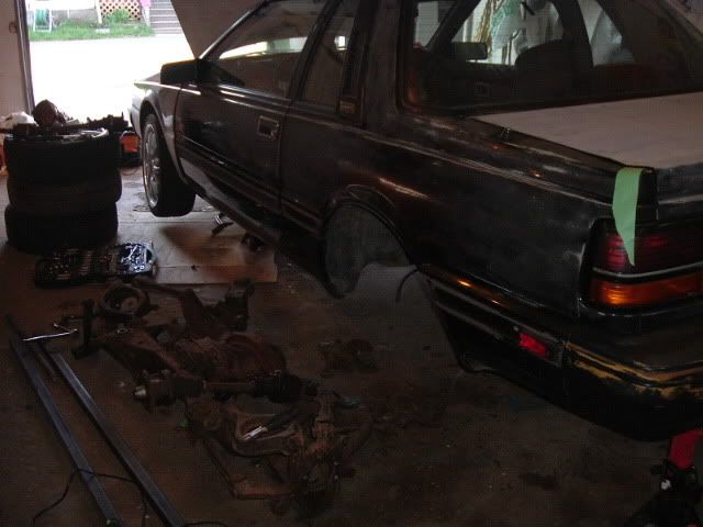

Subframe has been welded (professionally) and painted tremclad blue. It's nice looking now. E-brake assemblies are together (but confusing as all hell) and the rear end is going together tonight. I have also finished 75% of the rear shock towers. They will need professional metal work/welding to be strong enough to handle the abuse I will throw at it.
