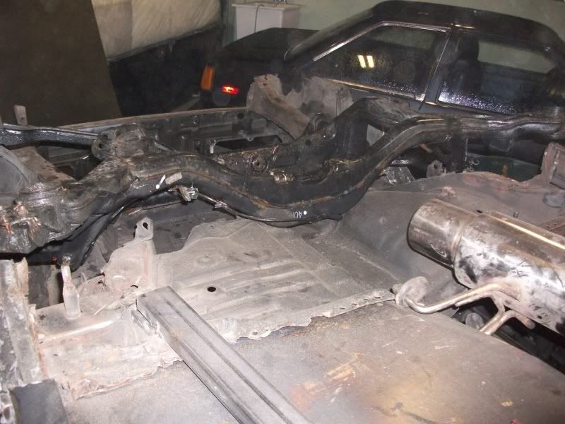

In other news.. The rear subframe from a Q45 has the exact same measurement (center to center on the mounting bushings) as an IRS S12. If it were the same length as an S13 subframe this would mean the wheel position would be pulled forward a matter of inches (A ridiculous amount of cutting would follow).. However, it also appears to be LONGER by a few inches (as compared to an S13).
This could mean there is a remote possibility that with the exception of the rear mounts (which are easier to do, IMO) the Q45 subframe may simply drop in. I will know by this weekend.

My first version of the S13 subframe swap was done that way, modified it to the S12 mounts.. It worked quite well until I destroyed it on a curb and needed to redesign the whole enchilada.
So, it appears the Q45 subframe was close, and while it COULD be made to work quite easily, I opted not to due to time constraints and the ready availability of S13 parts.
Some comparison shots of the two:
The Q45 subframe loosely  fitted. You can see the front diff mount 'member' is far to thick and hit the floor pan. On an S12 with a long snout diff, this area is much thinner overall..
Rear mounts dont line up much better than S13 either.
Oh yes, and as you can see - we have flipped the car..
Fixing rust holes, mounting the subframe, coaxing my floor pan into place, and plumbing fuel and brake lines will be the name of the game while the car is inverted.
