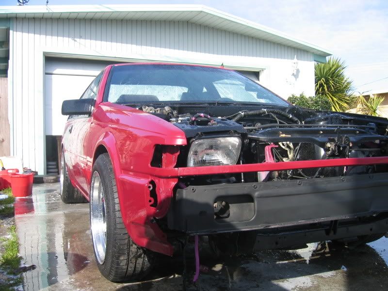

PREP + SPRAYING...
1. i would first recomend washing the entire car, that means wiping down all the jambs, cleaning in the wheel wells ect.
2.remove all necesary objects that are removable and mask anything you dont want to paint
i.e.lights, grille, trim, windows
3.pull out the 320g i listed in materials and get your bucket ready. dispense about a dime size of dish soap in the bucket. this will extend your paper life. fill with water. always let paper rest submerged in water for about 15mins to soften it up. note: soap is not needed but its something i like to do.
4. now go over the whole car with the 320g. sand in circular motions applying equal pressure. remember you should be wetsanding. dont sand all the way through the factory coat. just get the surface scuffed up and free of any scratched not cause by the sandpaper. let dry and you will see where you sanded. it will be dull. any shiny area should be gone over and sanded. after all sanding is complete use the wax/grease remover and wipe over the entire car. let dry and wipe down again. the surface can never be too clean. try not to put finger prints on the car as it possibly could contaminate your clean surface.
5. now that the car is sanded with 320g its time for primer. dont spray it heavy, it will run and not dry right. may cause the color to peel if you spray it too heavy. spray several light coats. wait 2 minutes between each light coats to allow primer to dry.
note:several light coats will build higher than a few thick coats, high build is key to not having scratching in finish.
6. so the car is primed and ready for color. now what? well the primer should feel rough to the touch. so pull out some 600G and start getting it smooth. you are elimating all the orange peel so the color has a smooth surface to stick to. do the entire car again. it sounds like a lot of sanding but after a while you get used to it and you get better so it goes by quicker. you may start with 320g but always finish your primer with at least 600g. now again use the wax/grease remover and wipe down the entire car. get all the hard to reach areas. let dry and wipe down once more. no finger prints, may cause fisheyes. now if you arent partially masked yet begine to mask off area you dont want paint to get to. i didnt take the time to mask and all i could say is overspray got everywhere. i spent more time cleaning overspray than actually prepping the car. so take your time and mask it off.
note: the better job you do here with the primer wetsanding the less you will have to color sand the car later on. the key is to get the surface as smooth as possible so when the color gets laid it wont follow the rough texture the primer had before you sanded it.
7.so the primers sanded smooth, finally time for color. shake the cans well. always start from the top edge of whatever panel your spraying and work your way across and down. again spray with light coats. from my experience i noticed spraying from 8 -10 inches away worked best. you may not get fast coverage but it will look more uniform. spray one panel at a time. allow 2-3 minutes between coats, more if sprayed heavier. repeat on the same panel until you have a nice thick, even color. by now you got enough paint to cover but probably not enough to color sand safely with. you may move on from here but i sprayed more. 1 more light coat, let dry for 3 mins, then give it a medium coat. you should be spraying more color on this coat than other. let dry over night. it will take at least 24 hours to dry completely, or enough to color sand with.
note: waiting in between coats is crucial. runs will begin to form if there is no drying period between coats. the paint builds and gets too thick to support itself vertically and will run.

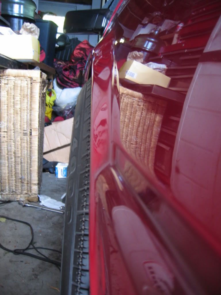

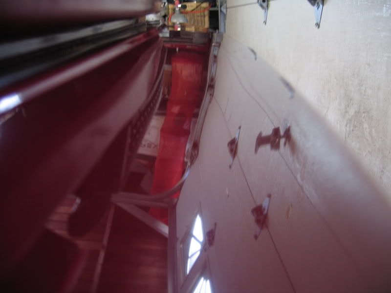

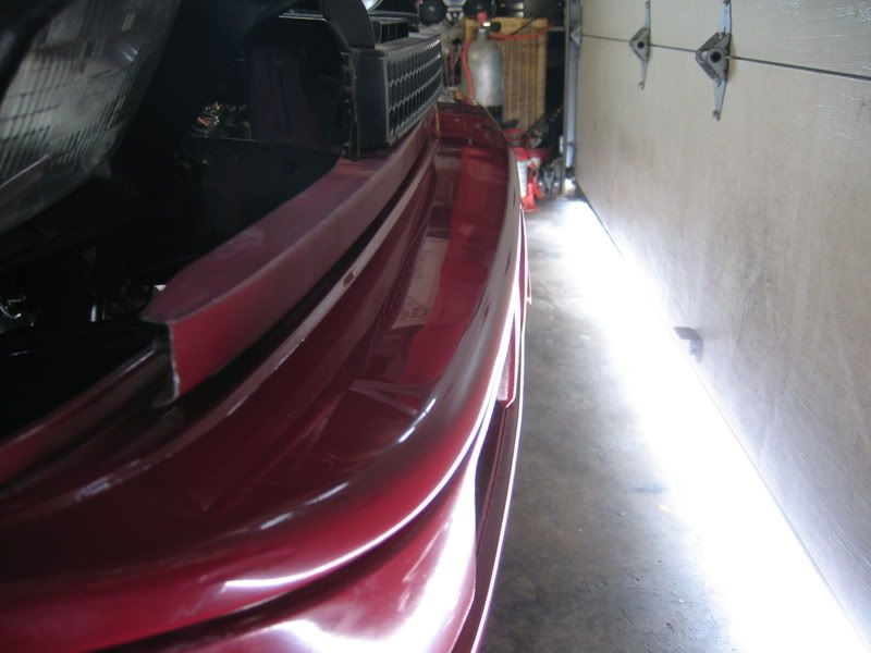

so the car is color sanded and its ready to be rubbed out. this is the hardest part. chances are you may burn through the paint. do not hold the buffer in one spot for to long. work the buffer around the panel, keep it compounded. dont let the compound dry.
this is where the yellow foam pad is needed.
using the buffer is pretty straight foward. stick on the pad, set to 1000rpms. nothing faster! get the compound and use about a quarter size for a 2sq.ft area, work it arond until it almost dries up. it should look really glossy. if not use another dip of compound and go over that area again. work a panel a time until its completely rubbed out and glossy. then move on. if your not getting a good gloss after you compound it you may have to go back and color sand some more. get the whole car rubbed out then wipe off any excess compound. pull out some good carnuba wax and wax it that day! the wax acts as a sealer for the compound. if you decide to use something other than trizact you may have to use a 2nd compound called a glaze. most rubbing compounds are followed up by final glaze but thats what i like about the trizact. it doesnt need a glaze, just a nice coat of wax. though you can glaze it, its not necasary like a rubbing compound. thes another pad you can get to finish it up even more. its a black foam pad used for polishing. its softer than the yellow and is also used with the trizact. i havent used that pad on my car yet but i will once i finish my build. the black pad will take out the super fine swirl marks left my the yellow pad if too much pressure was used. if your good enough with the yellow pad you dont need this.
like said above a polisher will not work. it may give the finish a semi-gloss but a real buffer is where its at. all in all good results from a rattle can come from the color sanding and buffing. many will argue its not worth it or its too much work. well if your pockets arent stuffed with $100's and you have nothing to do over a weekend then spray away. its a awsome alternative to urethane. its good experience and easliy maintainable. if it ever starts to look old no need to pay to have it matched and resprayed at a shop. simply go to home depot, buy a few cans and you know what to do. if i missed anything or you are still unclear of the process i will answer questions here and update the write up

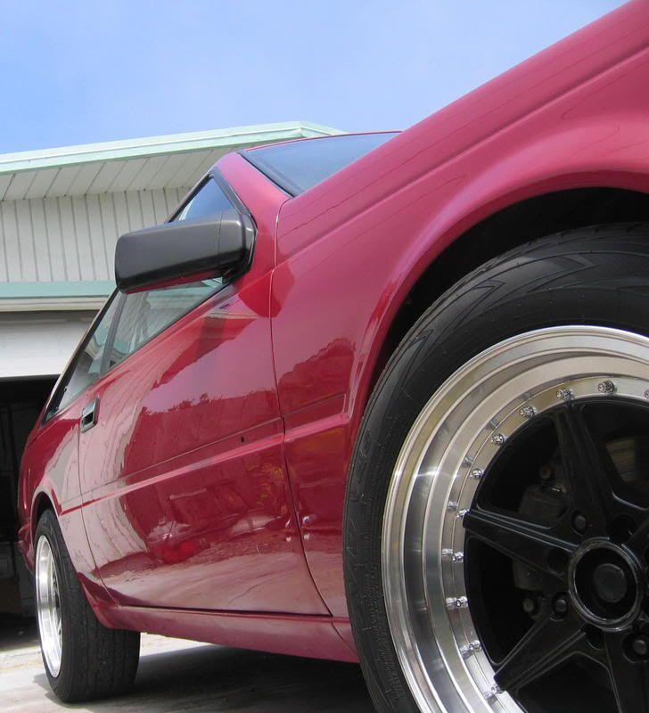

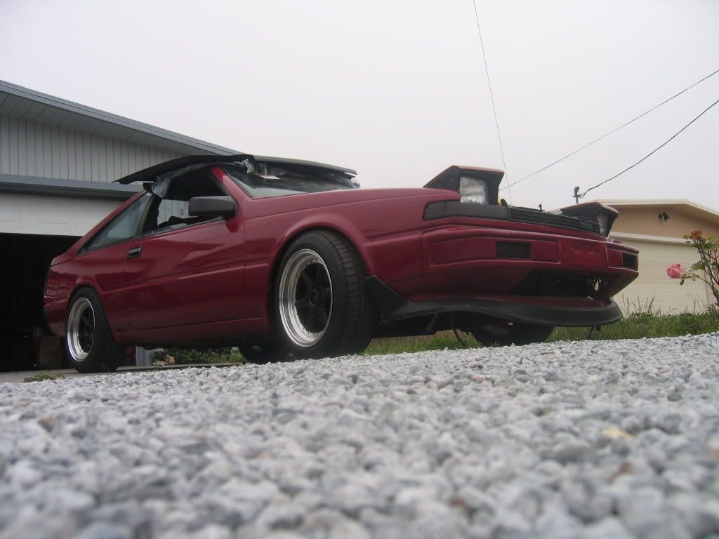

my finished results. well one side at least. i put the car in the garage after i took this picture and i havent started to color sand and buff the drivers side, roof and hood. as seen in the taping pics above you can see the dull finish, thats not color sanded, thats how it looks once it dries after you spray it. you can see the wavy panels, thats from me not using a backing pad when i was color sanding. also i didnt color sand or buff the rocker cause i have a se lip kit going on.
