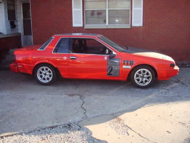

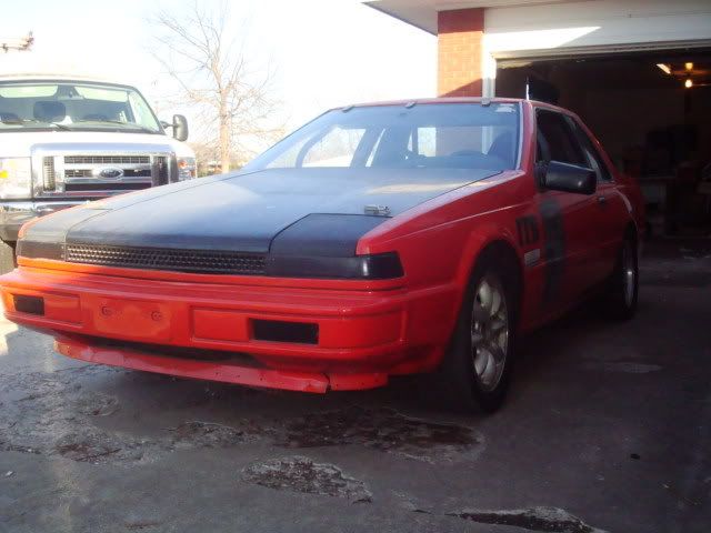

well, since many of you had seen pics of my racecar in the new members section, and i'm not quite new anymore, i thought i should start a page here. to refresh your memorys some of these pics will be repeated. and then ill show you pics of the cylinder head i just picked up from the machine shop.

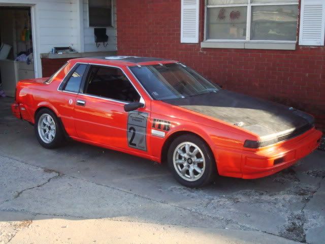

my car, origionally built into a racecar from the factory (im told)

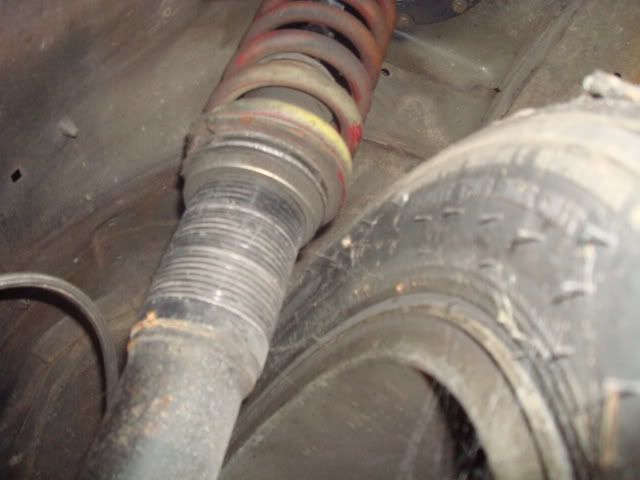

rear suspension= koni's, adjustable spring perch with custom springs, droop limiter, etc.

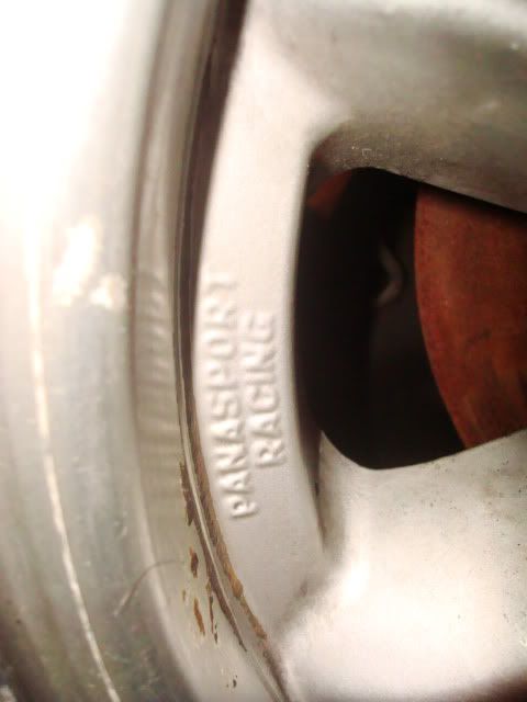

panasport racing wheels (2 sets)

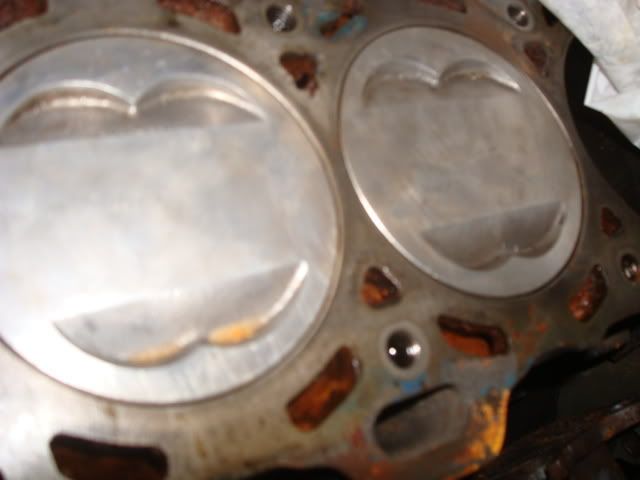

forged pistons in a ca20e
custom 7qt aluminum oil pan
me behind the wheel
front camber adjustment

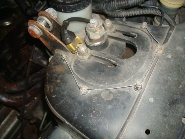

driver compartment, onboard fire extinquisher and adjustable brake bias
front coilovers with koni inserts

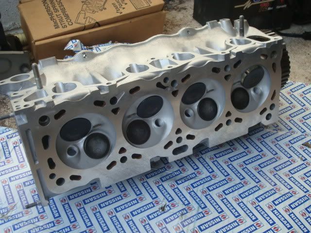

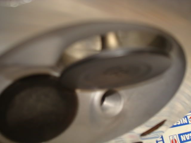

fresh cylinder head= pressure tested, hot tanked, decked .030, 4 angle valvejob, portwork

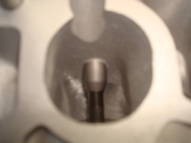

intake port
valve and cylinder

Nice!!! Good to see someone with the balls to mod a ca20e. Let us know how the motor performs once you get it back together.

arro is correct. handling comes FIRST. but once youve got that sorted out, more power never hurt anyone!  this car handles great, sleight understeer on very slow corners, like an autocross, but at racing speed it is really predictable, and ive got the rear adjustable sway bar set to full stiff, so it rotates well. even when the rear steps out, it sits there without snap-spinning. im gonna ask don if he still has his dyno, im curious too!
