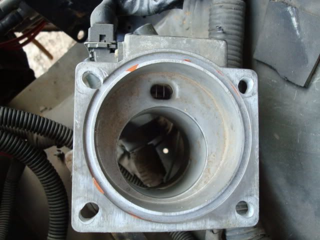

Quote from: bluke1

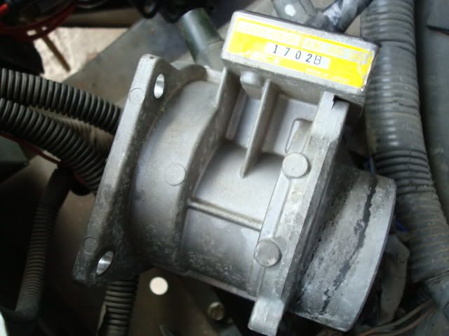

im pretty sure its a s13 maf, here it is
as far as the year, lvdave looked it up on his nissan program at work, so i dont doubt what he said.
That looks like you have an S12 *turbo* model MAF,  it looks exactly like mine, and I expect that considering the history of this car, it is, because most of the modifications done to it were before the S13, and all they had were wha was available from Nissan in '84 or what they could custom make themselves.
Bluke I'd really like to see better pictures of your rear camber adjustments, and if you know how many dergrees of adjustment that gives, do tell.
bluke1
that would make sense about the maf because the ecu has the dial type method of checking the code as opposed to the on off switch that the ca20 uses. although ryan hampton called it a 240 hotwire conversion, so im not really sure. might need to look up the part #. in a day or two i will go wild with the camera and get some of the pics you guys want to see up close!

I correct myself with this:
S13 KA24DE MAF is how it's listed, so I assume that is what they used until the S14, which used this:
This is listed as a KA24E MAF, which may indeed be what you have:
Nitro
It's more likely like the first one Arro posted - KA24DE. Look at the wire jack (contact) - it is bolted to the body as in the first pic. The last pic (KA24E) have this plug made in one body with the big plastic part.

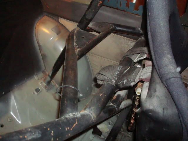

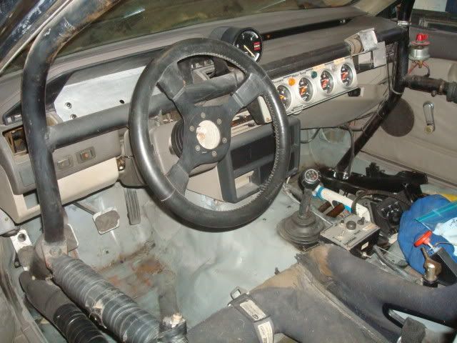

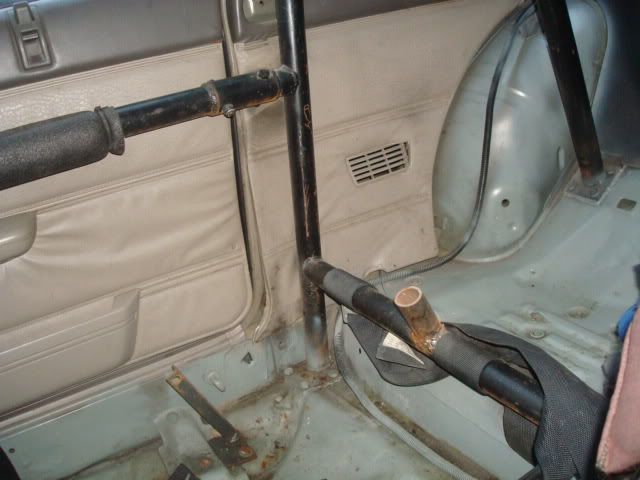

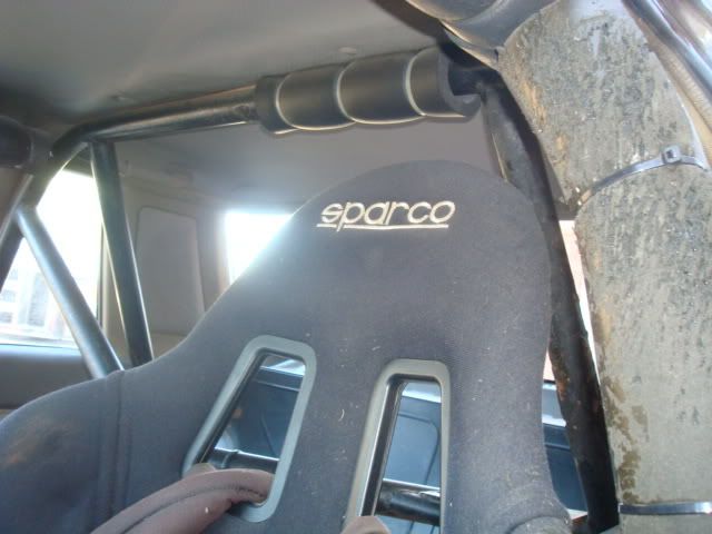

heres a few of the cage that i have, i can take more specific ones if asked

OMG SO COOL IT BLOWS MY MIND!!
This, and most of the interior is still there.  so badass (I understand is probably a class reg. thing)

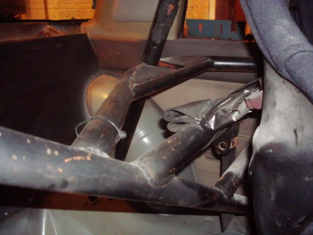

I would like a picture of the mounting point of the main arch of the cage. Also, I guess the cage is SCCA certified??

the cage is scca legal except i think they now require a 'nascar' style driver door bar. ill get more pics later today of the mounting points. the race is at hallett motor racing circuit, located a few hundred yards of the turnpike near tulsa. you can find directions and a track map here http://www.hallettracing.net/ . i will be racing on the 25-26 of october. it would be cool if you were...somewhat local

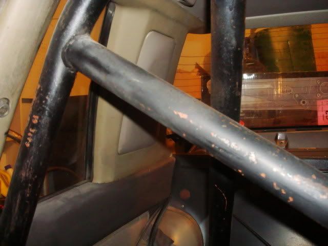

bluke1
#71
Quote from: bigjer

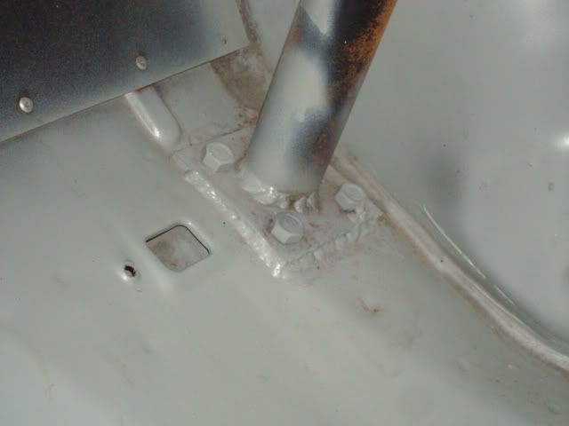

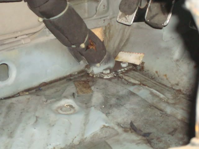

here are some pics of the mounting points. i will tell you that in the cages that were built by kirk getches, a master cage builder/engineer, look a lot better. this cage was built in the 80's. scca rules allow a 'footprint' dimension for the main roll hoop and other mounting points, and kirk would maximize it st the strongest structure points of the car. he would also drill through the dash to run his bars, instead of curving around them like my cage. the scca rules allow some ingenuity, they just dont spell out what it is. nevertheless, here is what mine looks like
you can see the footprint could be larger, and also tie in with the vertical structure (based on scca rules). the key is to maximize the footprint of the cage to tie into the most structurally sound points in the car, not just the floorpan where its convienent. i may see if i can get some pics of better mounting points like ive tried to describe and post them up for you.
oh, and i also installed a new windsheild today, getting closer!!!

DjayS12
I think I get what you mean. Just draw a short diagram on paint. Should look a bit like this?
That's how I plan to design my roll cage, minus the two front arch (basically a 4pts instead of a 6pts). I wan't to keep my car street legal and these two front bar aren't legal for street car.

DjayS12
Nice pics. That is exactly the model of roll cage I'm willing to go with. The only thing is about your rear mounting point, I won't be able to reach that point in my notch, unless I go in cutting. I'm probably gonna mount it in the same spot as bluke1 roll cage.

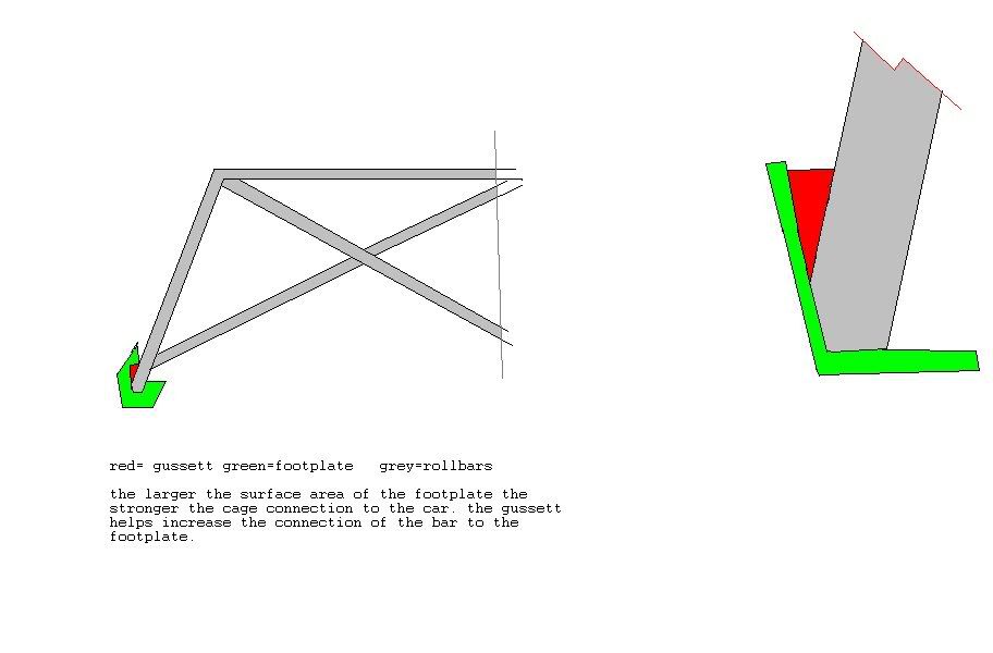

redrockets cage looks nice! appears to be strong and streetlegal. heres a simple drawing to give you a better idea of what i was talking about
see how the 'footplate contacts what would be the floor and the side of the cars structure in a large area and the gussett helps tie in the whole thing. multiple gussetts can be used, depending on if you are trying to make it competition legal or just for personal safety.

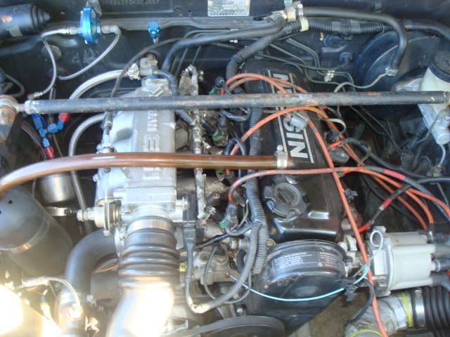

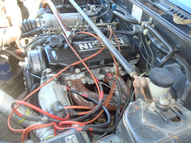

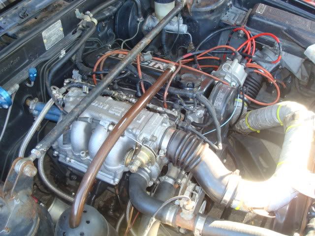

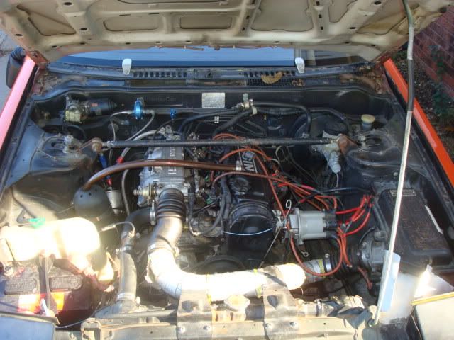

sideways_s12

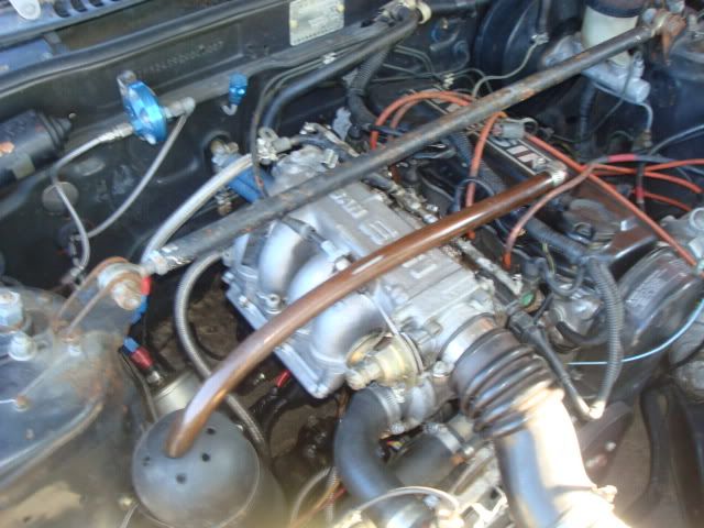

can you snap off some pics of the engine I am really interested in how it looks also do oyu have itbs really want to see that
nismologist
im calling koni and trying to get them to maybe find the plans or something.i dont know im calling and trying hard to get them.
YOU THOUGHT SO, BUT I KNOW SO.
-Macho Man Randy Savage
bluke1
sorry, no itb's, and it doesnt look very impressive, scca improved touring rules dont allow for much modification to the engine... most if what it has done is internal, but you might notice more of what it doesnt have, like all the emmision and idle control stuff. and if you look, it has a maf instead of the factory vane type airflow sensor and the rules require using the factory air intake box, but the pipe is custom.
