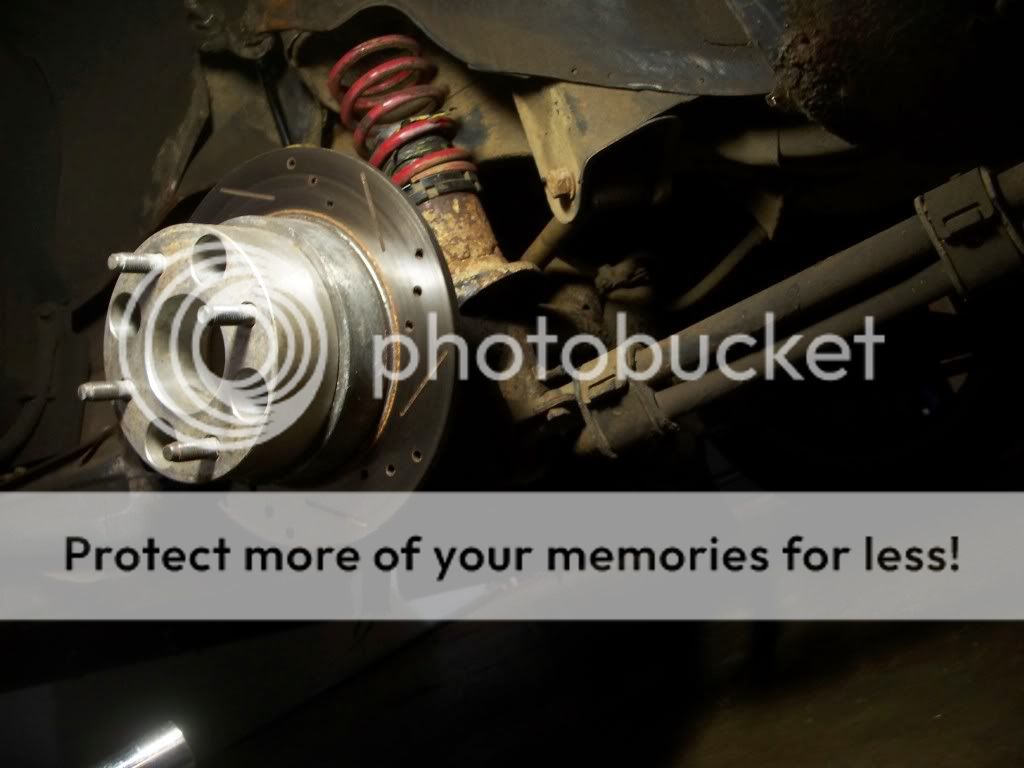

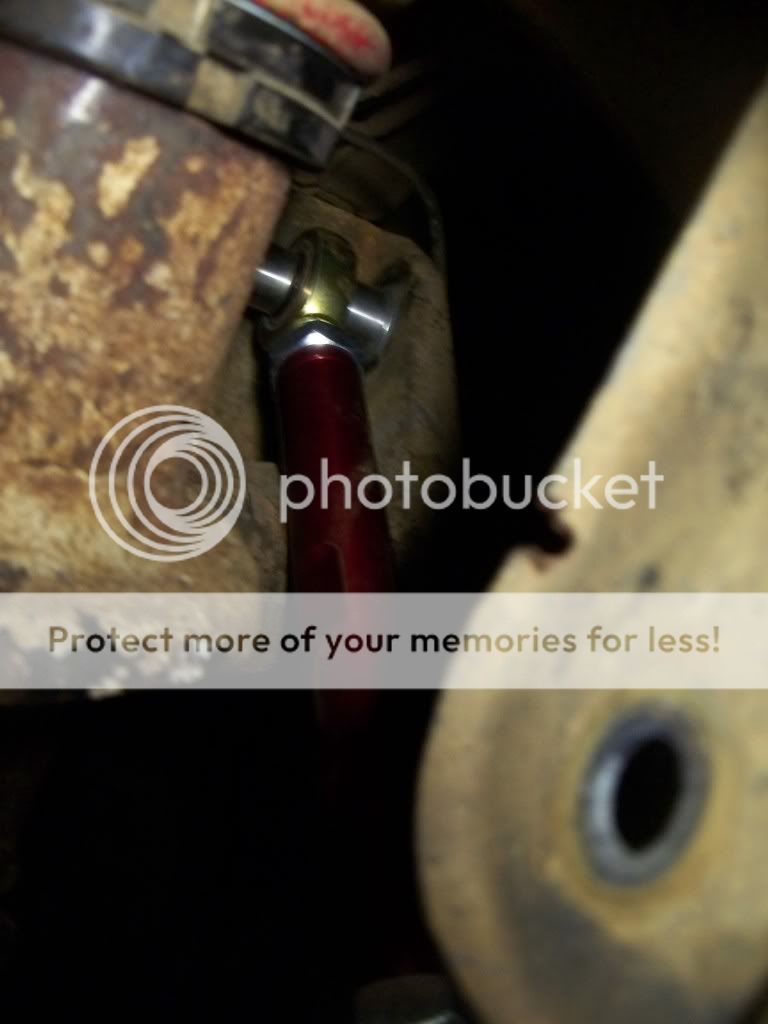

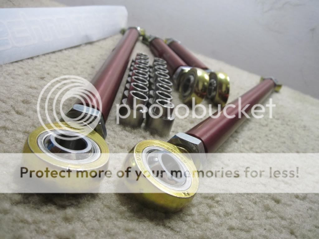

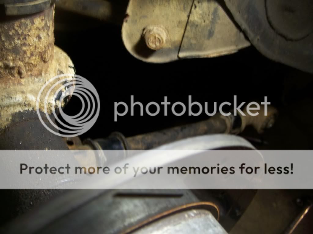

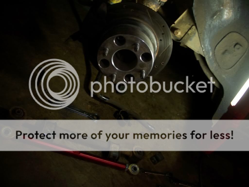

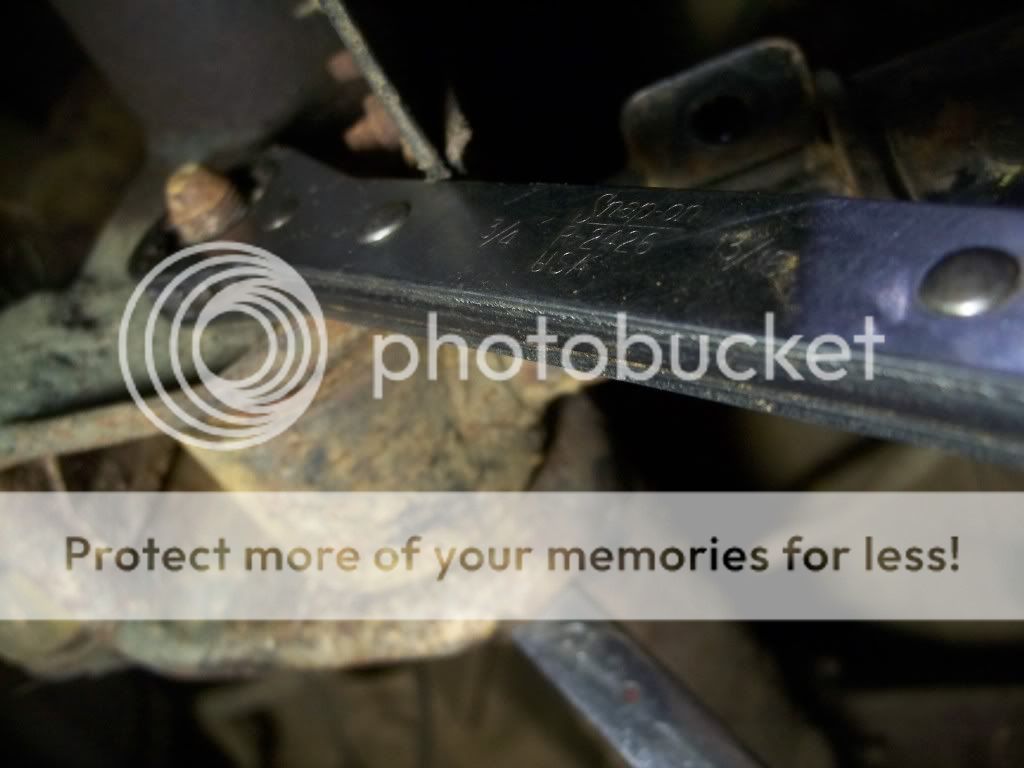

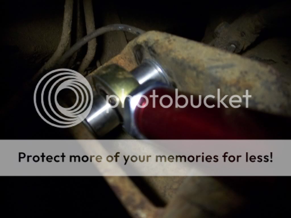

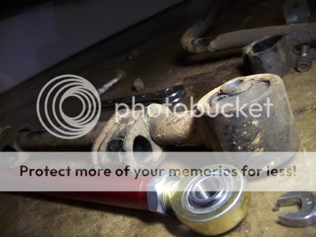

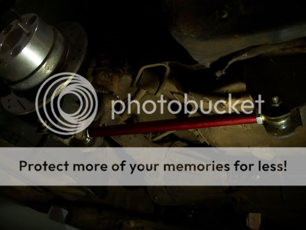

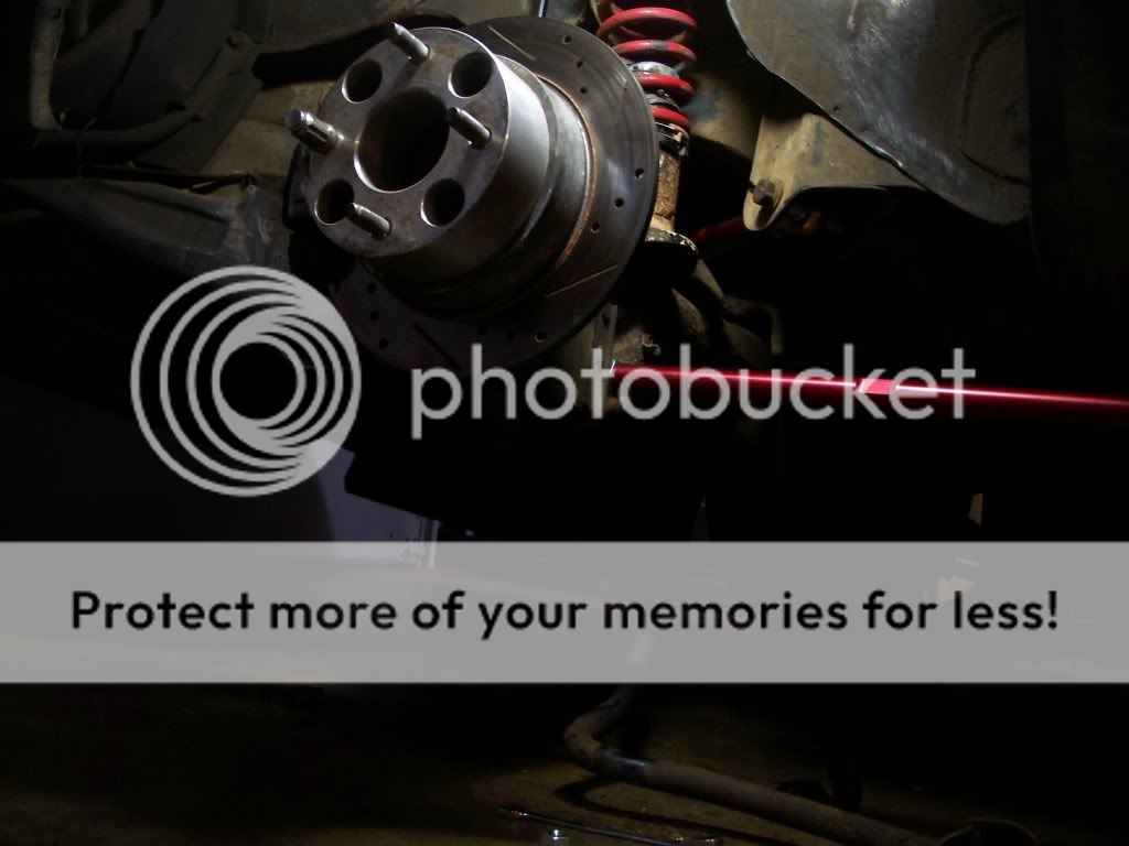

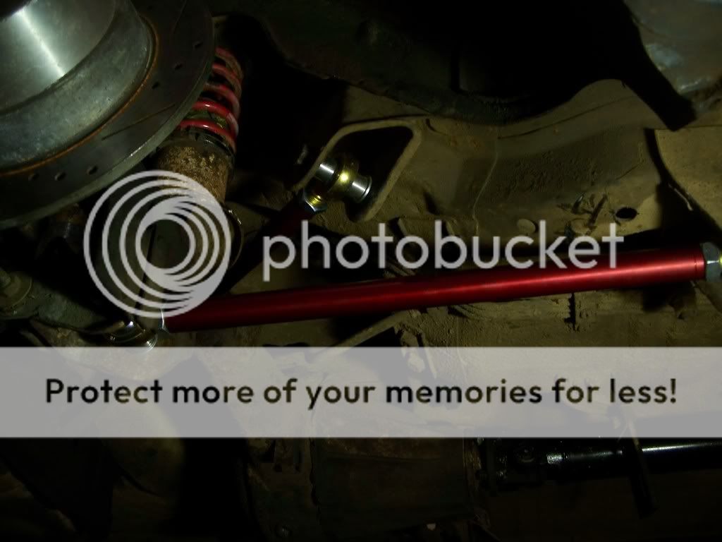

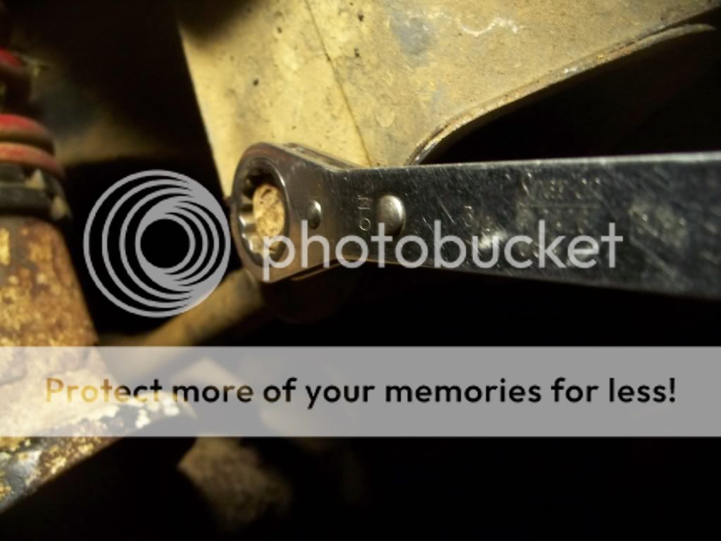

k guys here you go.
my review on these links
emailed techno toy tuning, yada yada, got set up for around 380$ shipped. very good customer service and turn around time was updated for me as i asked
here they are
BOTTOM LINK
brackets for the swaybar gotta come off
15 mill for the larger one
12 mill for the smaller one
19 mill for the big bolts that hold the link on
yank it out
comparison
fitment,
the BOLTS provided with the links are too short! but come with same thread pitch nuts.
it comes with ALOT of washers, on the lower longer link, i used 2 washers per side. for close fitment
note** on the TOP, i only had to use 1 washer per side.. guessing its a different sized bushing
TOP LINK!
19 mill, the front side towards u doesnt use a nut, its got a threaded insert, the back one is a nut/bolt. i still had to reuse the stock bolts since the ones provided were too short
heres where i used 1 washer per side up top to fill the inner gap it has
done
« Last Edit: 02:15:55 AM / 04-Oct-11 by David B »
