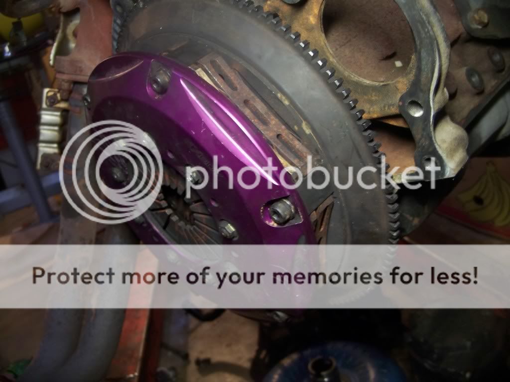

WTF is that torque converter doing in the background? just chillin?
Twin disk clutch FTW
ka is obviously auto. just took the tq conv off

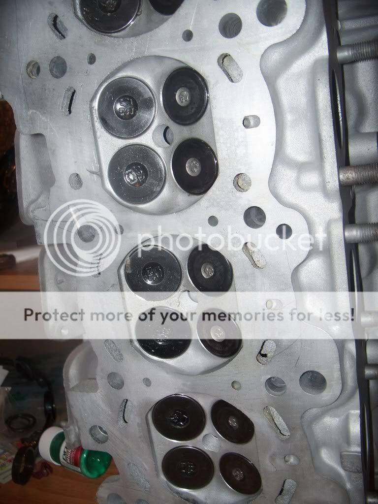

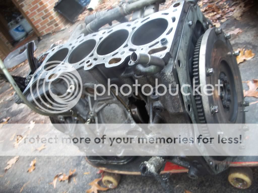

head is back wippieeey

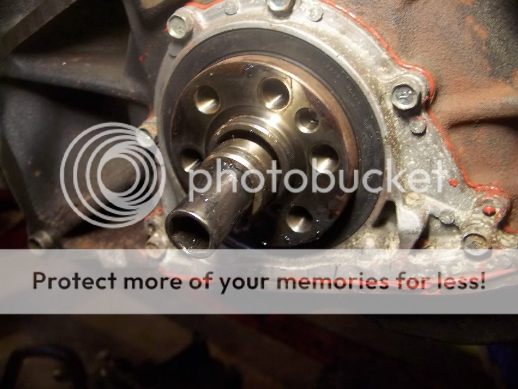

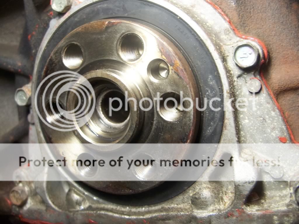

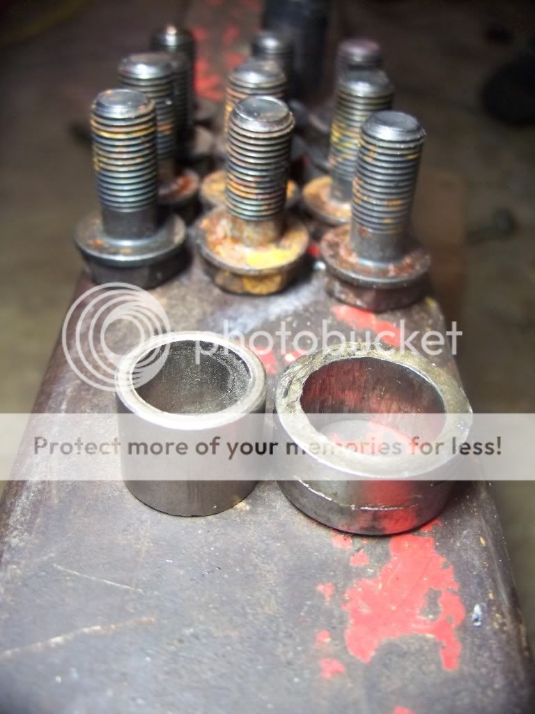

pilot bearing install

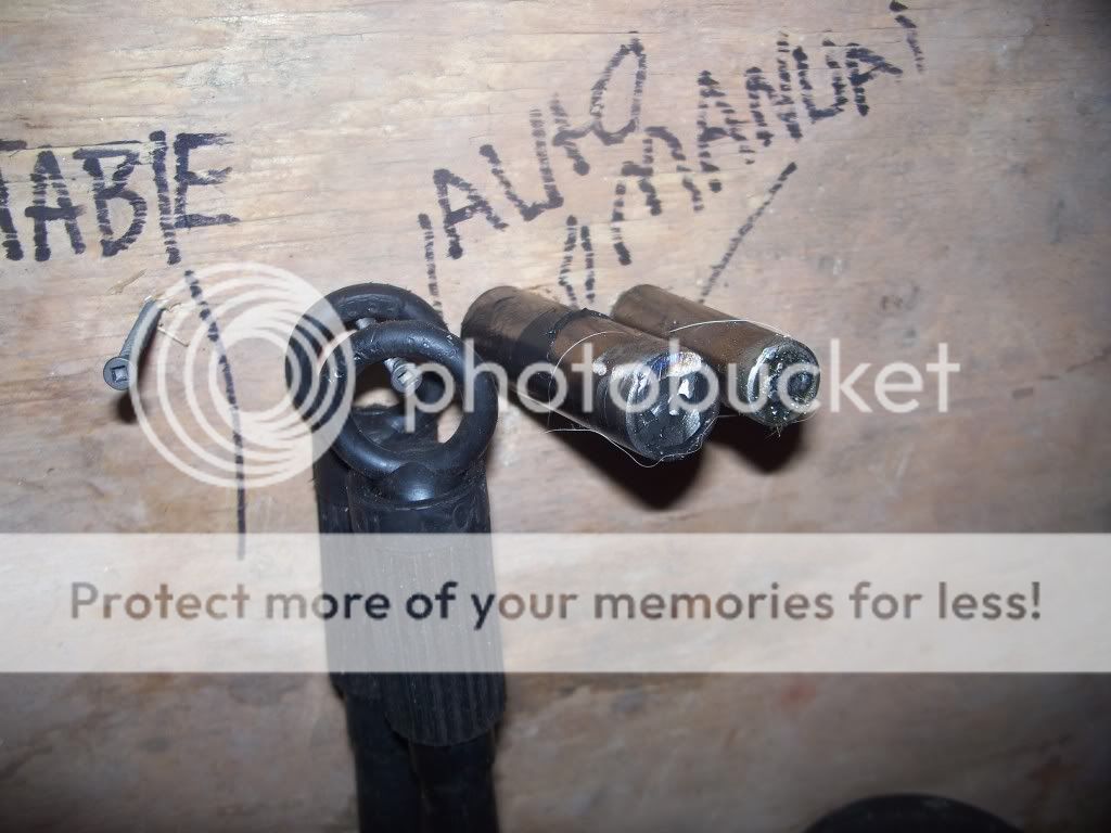

to remove the pilot bushing i use a ton of grease, and a socket with a welded end on it, to force the auto bushing back out.
9/16ths socket for auto bushings
just, smack that fucker in there with a hammer real hard (make sure you pack with lots of grease)
sometimes, i add some eletrical tape to the socket for a better seal

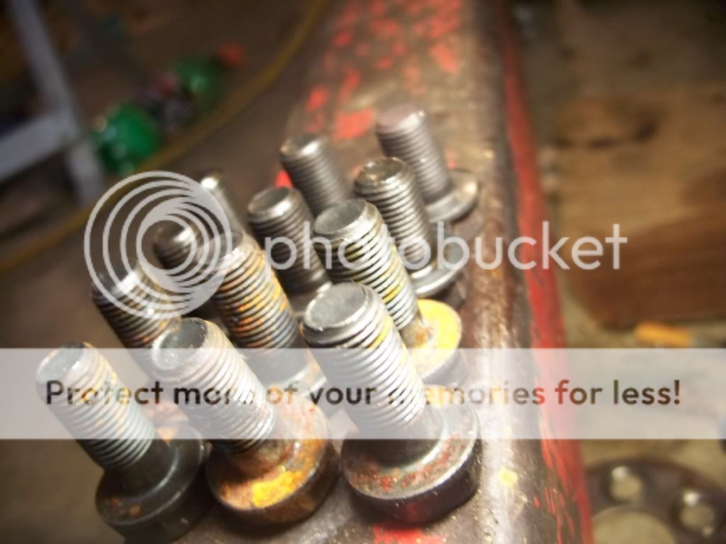

dont forget your MANUAL TRANS BOLTS
they have longer threads and specify MT on them
auto bushing on right, manual on left
tap the new one in
pray you installed your twin disk correctly

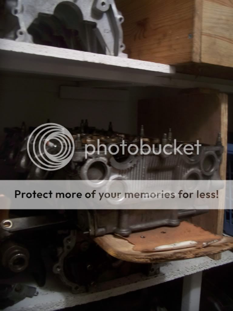

and, free junk of the day!
total spent on build
$2.09 on a pilot bushing

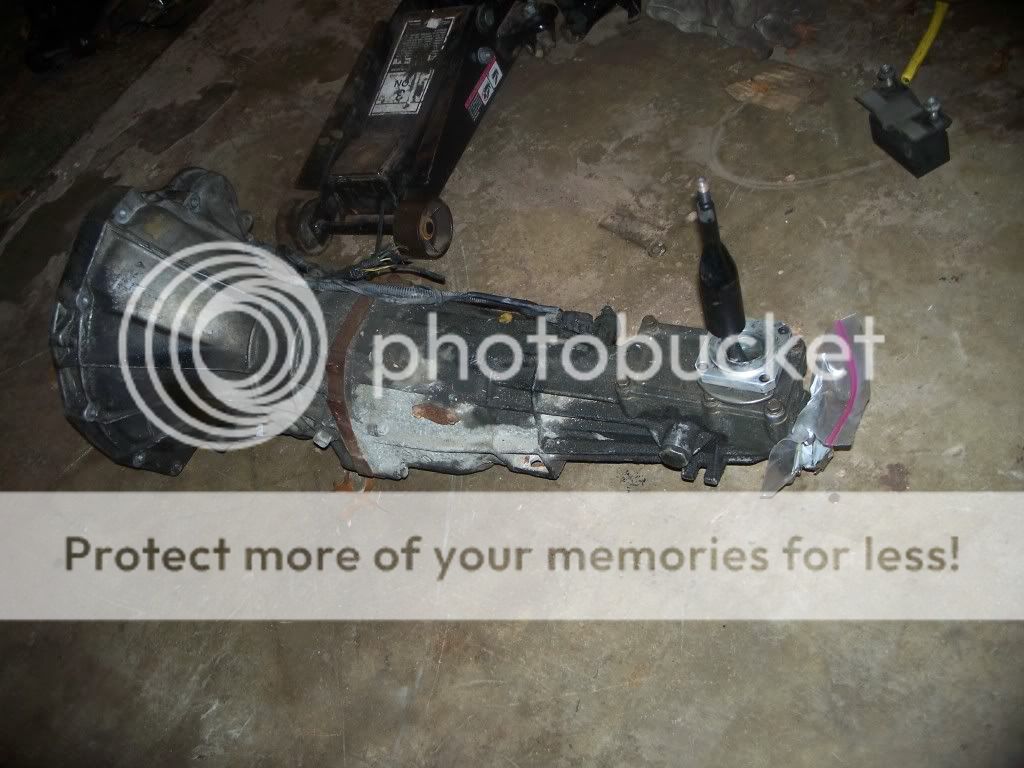

im getting trans fluid and coolant dropped off from a friend at toyota, motor should go in tonight

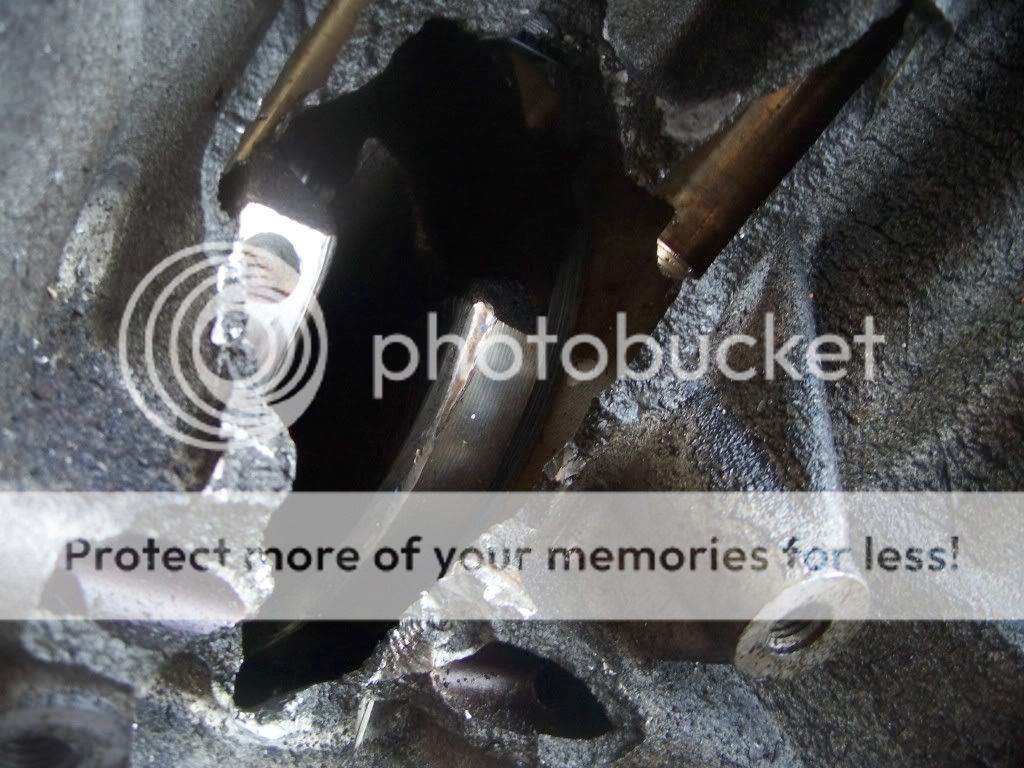

I just love how you carry your engine blocks around...
Did a rod inside that block wanted to get into shape???  That would explain why it decided to leave for a walk...

yea dude, i pick up around 4-5 motors a month
swaps at my house or a friends every week
where does all this shit come from!
i scrap alot of it/sell it

Does using grease/wet paper + hammer + socket to remove an auto bushing damage your thrust bearing?
WHAT WOULD YOU DO ON A FIRST DATE THAT WAS TURNING SOUR?
I'd run home and play dead. The next day I would call all the newspapers and make sure they wrote about me in all the dead columns. -Craig, age 9
Offline Jay
  • Now v3.0.14 rev. C... Cowbell included!
  • Location: Calumet, Mi
  • Posts: 5,543
  • Vehicle: 1989 BMW 3 Series
Re: S12 Sr20 Drift Car : KA!
« Reply #1697 on: 09:03:48 AM / 01-Dec-10 »
Only if you do it wrong. by wrong meaning not having a good seal and end up bottoming the socket out before the bushing comes out.
i like gay porn. but i dont post that in my sig links.
  • Posts: 7,366
« Reply #1698 on: 10:12:01 AM / 01-Dec-10 »
you mean, crank thrust washers?
no not at all, and you deffinetly shouldnt bottom the socket out much
has to be packed with grease
you need to hit it hard enough, so that it feels like your hitting pure metal though, if your wacks feel kinda cushioned then your either A shoving grease out around the socket (where eletrical tape helps), or b not hitting hard enough
ive done it, around 8 or so times... never had a issue with any motors..
did wonder if AUTO cranks and balanced for tq converters though, and if clutches threw the balance off
also, the crank on MT trans's has a PIN, for the flywheel, auto does not..
but i make sure i line up the hole where the pin was before i bolt it down
