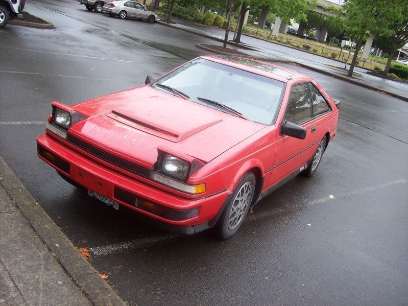

So my roommate and I are starting a 200SX project. It's actually his car, but I'll be putting about $1,000 into it in exchange for his VQ35HR/6speed. He's been on here before, TitaniumBMX, this is the 2nd 200SX to wind up in our garage. The last one turned out pretty cool and was sold a while later, so here's the next one...
I believe it's a 1986, but I could be wrong. Maybe 87. Notch. We got it for free from the goodwill store while looking for old computer parts, it was sitting abandoned in the parking lot and they told us to take it cuz the police wouldn't and they didn't know whose it was. It'd just been sitting there for months. So we brought it home, dusted it off and hotwired it. Fired right up, the only other mechanical problem was a flat tire and no radiator cap, so why it was abandoned is beyond me.
