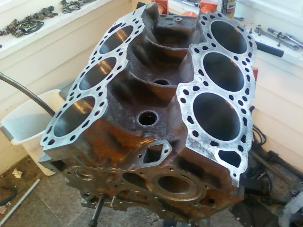

FINALLY, i can post some progress, even if it is just me getting my parts back.
i DO have a question tho, ill have to pick up my own (probably digital) micrometer to find out what size bearings i need now, correct?
heres the sauce:
Pistons
Old rods, bored/honed to be full floating (turns out they had to be, the pins for the wiseco pistons were just under 1mm larger than stock) with large end freshly honed.
Cleaned/polished factory crank
And last but certainly not least, hot tanked, bored/honed 40 over block.
does anyone have any idea if wiseco rings are chromoly? (i think thats what they are called) they are harder than my block = not a good idea in case something goes wrong, they will fuck up the cylinder walls rather than break like normal graphite...? carbon...? ones...its been a long week, im a little out of it.

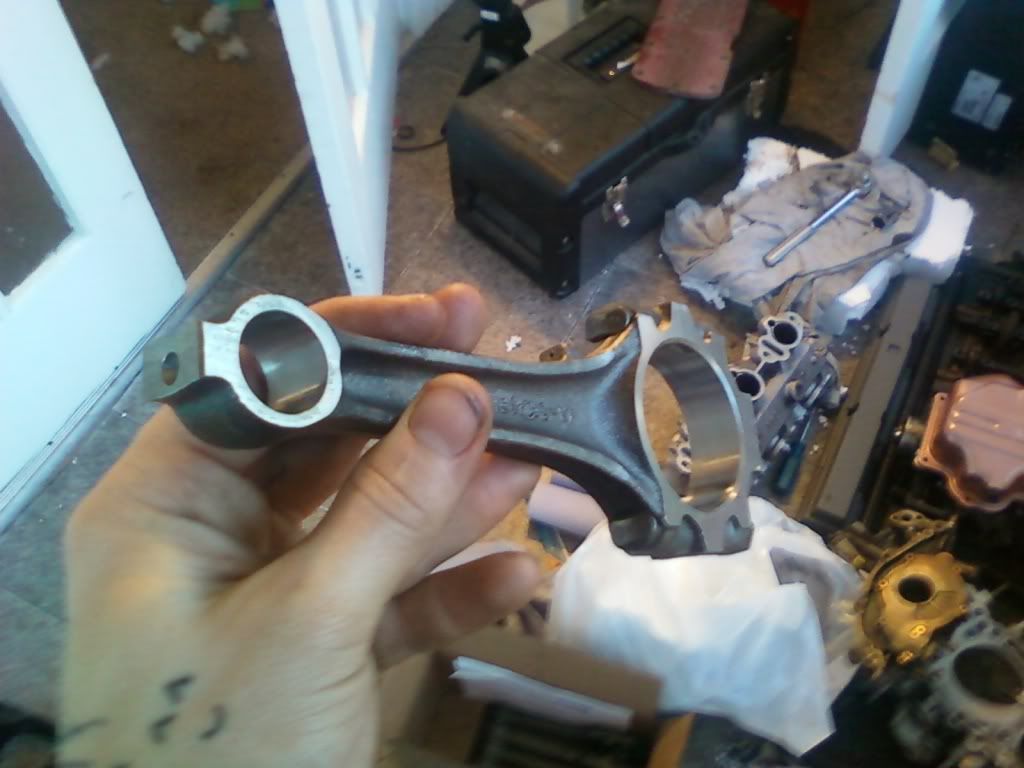

ok, so ive gotten the main bearing cap back on, and am currently trying to put my new pistons on my rods, but i cant remember which direction is supposed to face forward on the rods themselves...are the letters and numbers that are cast into the...neck?...portion of the rods face the flywheel/rear of the motor, or the front.
From what i have been able to gather from searching a few dozen pictures through google, going off these ones
http://nissannut.com/maintenance/vg33e_upg...ain_caps_on.JPG
http://nissannut.com/maintenance/vg33e_upg.../oil_pickup.JPG
and then looking at the ends of mine (assuming all the rods are created from the nissan plant in the same matter *machined from the same direction*)
it LOOKS like the lettering should face the rear of the motor, with the oil squirters pointing towards the passenger side  (left side when looking from the front towards the back) of the motor

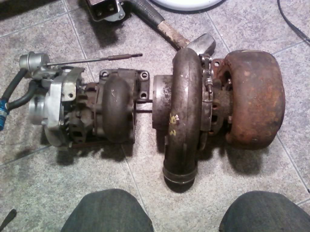

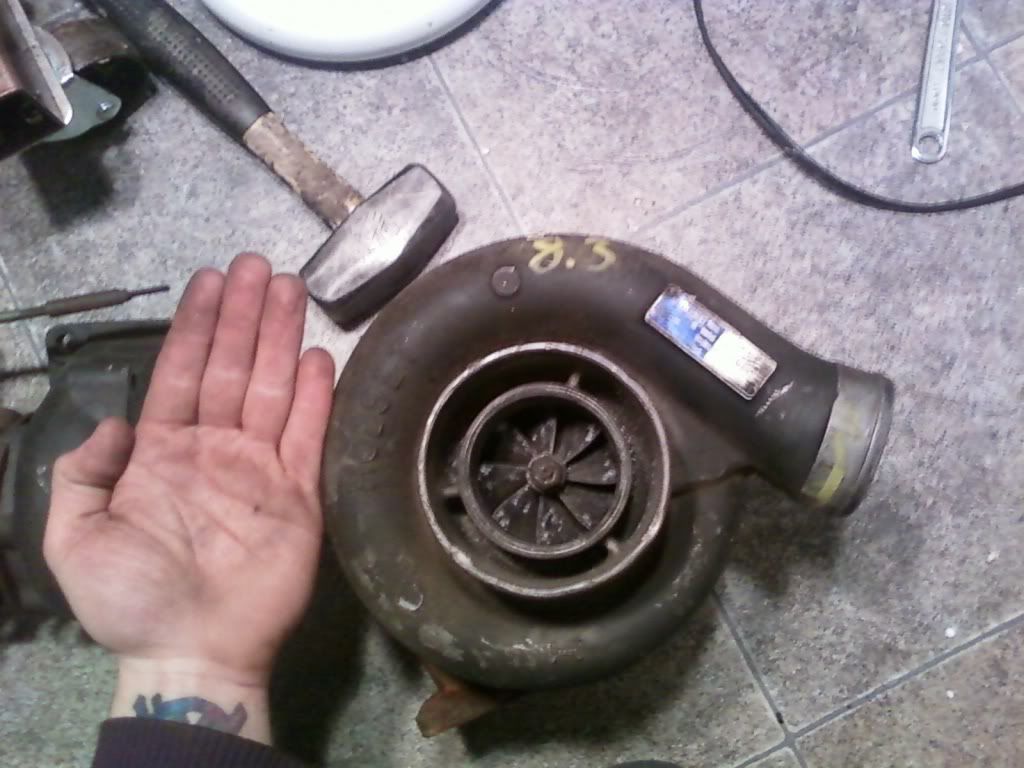

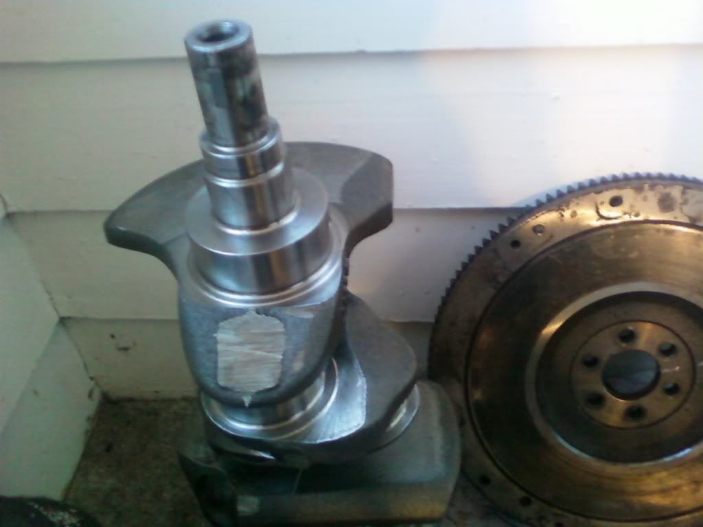

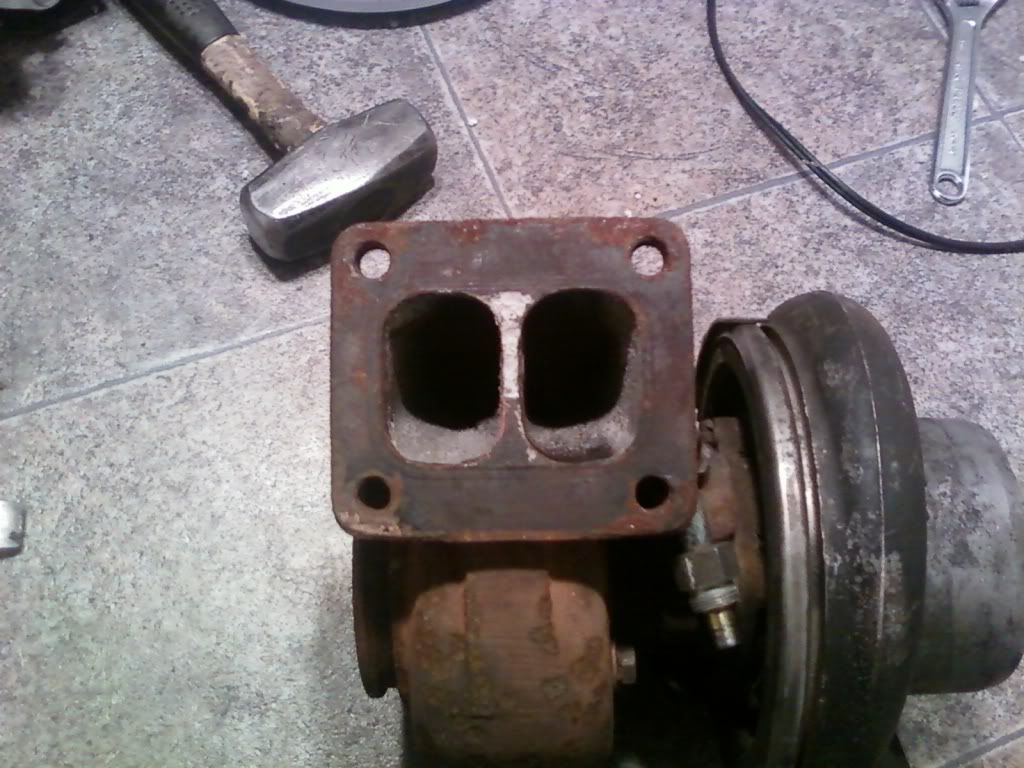

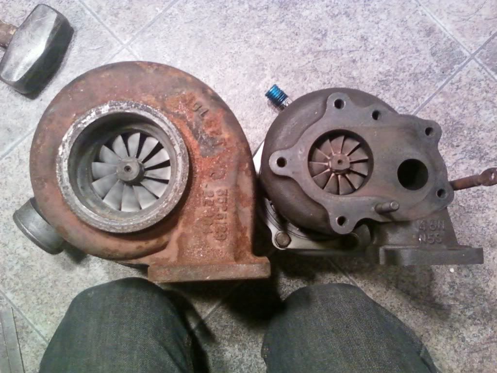

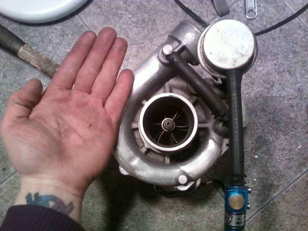

allrighty, well currently im pissed off because i cant get any of my rod caps off from when the machinist tightened them down to hone out the large ends. so the work of beginning to put the rods/pistons back into the block is at a standstill until i take all my rods BACK to my machinist tomorrow morning, possibly to have a few heated comments made about how they are torqued down at least 2x more than they should be...i hope they arent fucking stretched out
ANYWAY, on a bit of a better note i guess, heres some more pics for you guys...

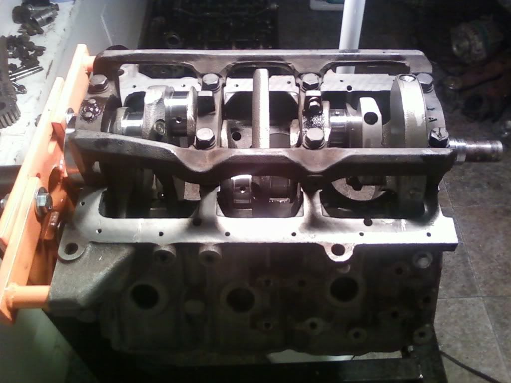

Crank in and torqued to spec
Small turbo (stock t3 from 84t Z)
Holset H1E
Twin Scroll
Side by side of the future cohorts in destruction
Another side by side of the two (this one is a bit better show of just how much bigger the H1E is, and yes, thats a 4" outlet)
OH! one quick question for Iggy, how much will that ugly ass exhaust housing be able to get cleaned up? Theres also some sort of hard silvery/aluminum looking build up mostly on one of the two scrolls, its in the exhaust outlet as well...ideas?

I can media blast the turbine housing or both housings if u want.  $20 per side unfortunetly but thats cuz its not my blast cabinet being used.  The compressor housing would def look brand new after blasting.  IDK bout the rust on the turbine housing though.  I'll do what I can.  If rust is a problem up there u might consider ceramic coating it.  I can have that done here in town but I'll have to get a quote on it.  Should be something like 60 or 80 bucks but not sure.  lol at aluminum build up.  Previous owner melt a piston?  Might be a concern for the turbine but turbos that size are usually pretty tough.

On a bit of a different note, would the media blasting get rid of the buildup crap? if so im more than willing to pay the $40 to have it looking as good as it no doubt will perform

don't know 100% until I try to clean it.  Stuff on the inside is usually pretty had to clean if it doeasnt come right off but I can get the rust off.  But rust spots usually come right back supr gay.
