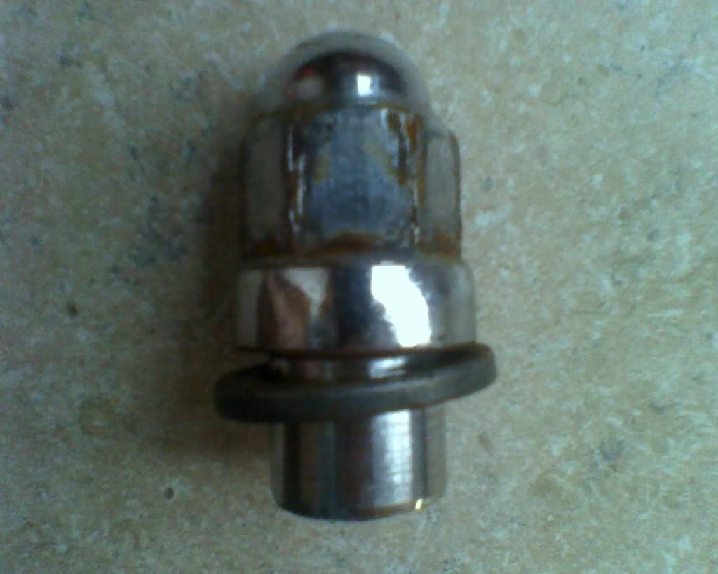

are these yours?
heres the ones that i use that fail. they snap in half... i spent like 40 bucks for a bunch of them awhile back and probally will never use them again
i cant find the oens like in the first pic.. i found those shitty ones below at carquest
« Last Edit: 01:41:57 PM / 28-May-09 by David B »

are these yours?
Style is the same.....but the washers on mine are seperate..the one in the pic looks like it's part of the lug

okay thanks for helping me clear this all up. but the OE ones like yours, and the one that sterling posted awhile back, (pic u quoted) looks alot more beefier then my pos lug nuts. must i find them.

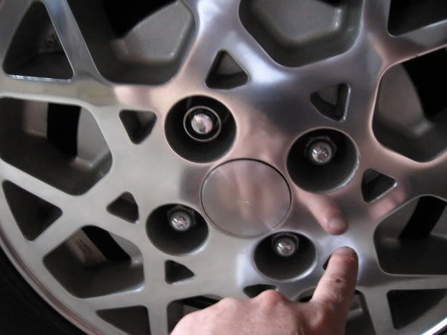

here is one of mine "Acorn" style I believe..........
« Last Edit: 01:51:15 PM / 28-May-09 by Keith »

How Much Of A Spacer Should I Get?
« Reply #33 on: 10:16:56 PM / 28-May-09 »
Quote from: Keith
That's a "mag" style, this is an acorn:
has a tapered end.
That's right...you're right.  It's been a while......I was thinking of my Maxima
