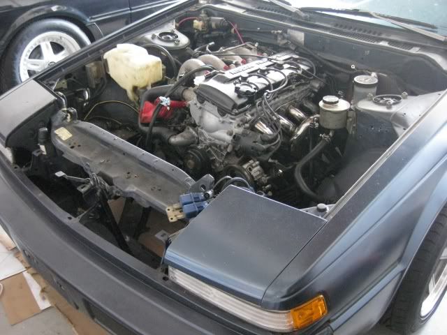

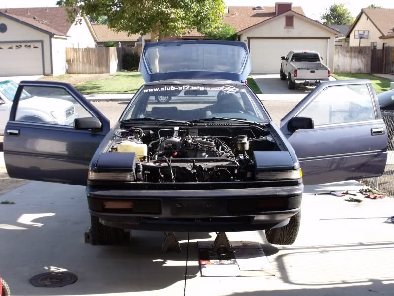

So back in May, I teased you all with the pic above. It's time I updated things.

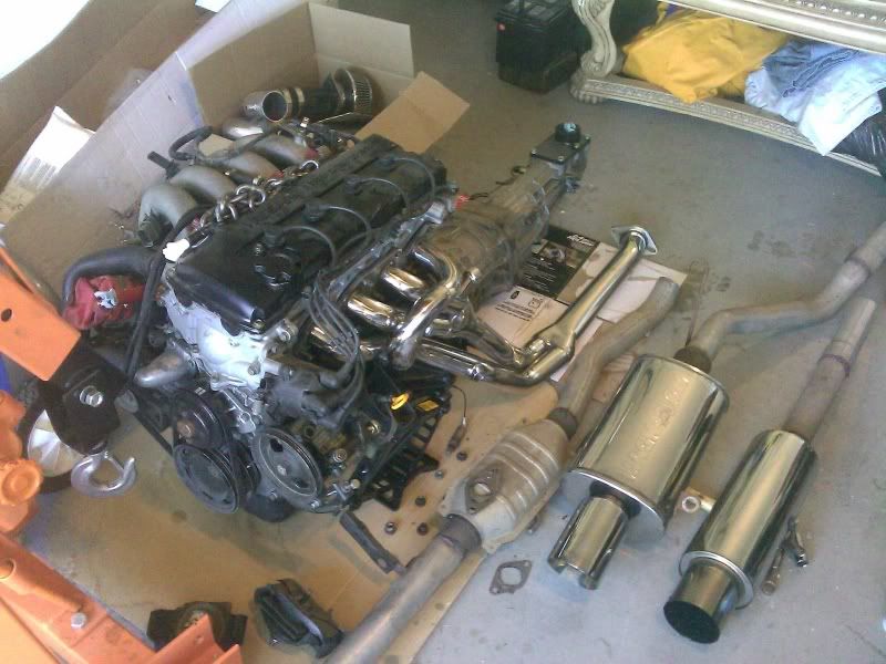

While the CA20 still ran decent, there was no love for the automatic trans, and the desire for more grunt was pressing on me more and more. My other car had been hoarding a rather nice powerplant in its rather underqualified chassis, so
we took the liberty of remanding it of its goodies.
The first car was a sort of test bed for the KA swap, and since then, more refinements and ideas allow us a better swap. Also I wanted to do some things a bit differently.

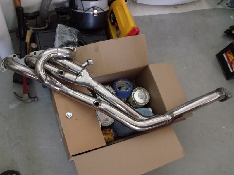

S13 KA24DE header:
I had to decide between a couple different axle-back sections I had ended up with. In the end, I stuck with the one I had before.
I also had to get the EGR port cut off and remounted shorter so the EGR tube would still clear the firewall. Otherwise, it went on perfectly.

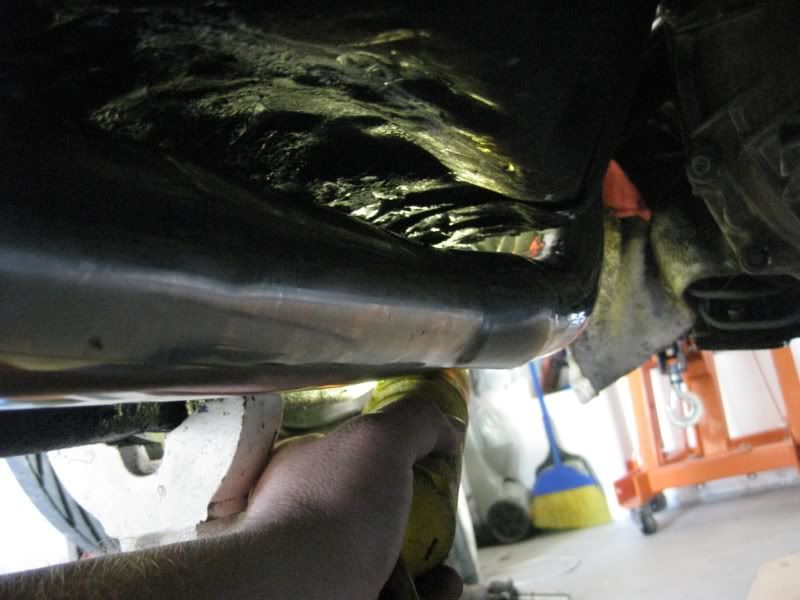

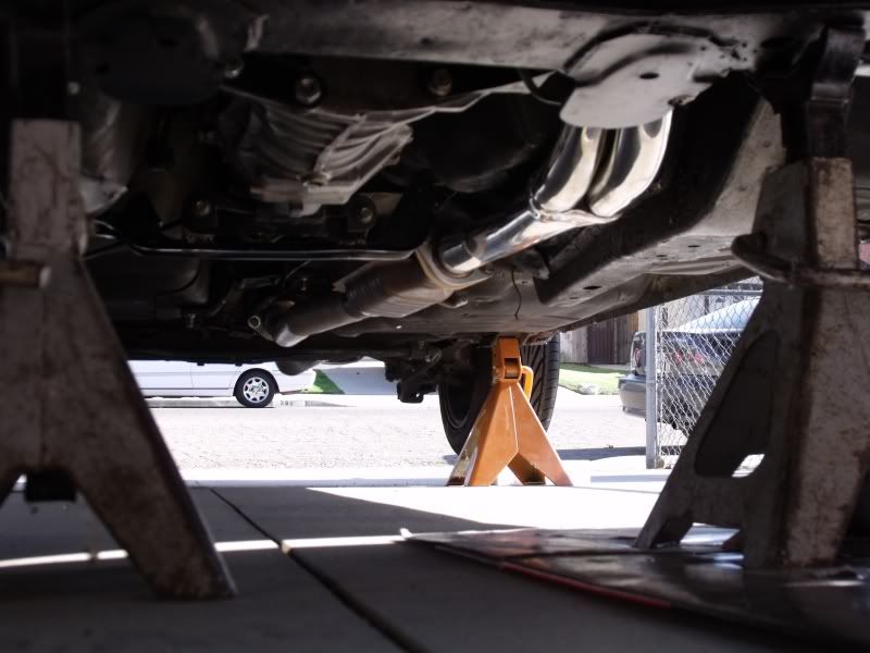

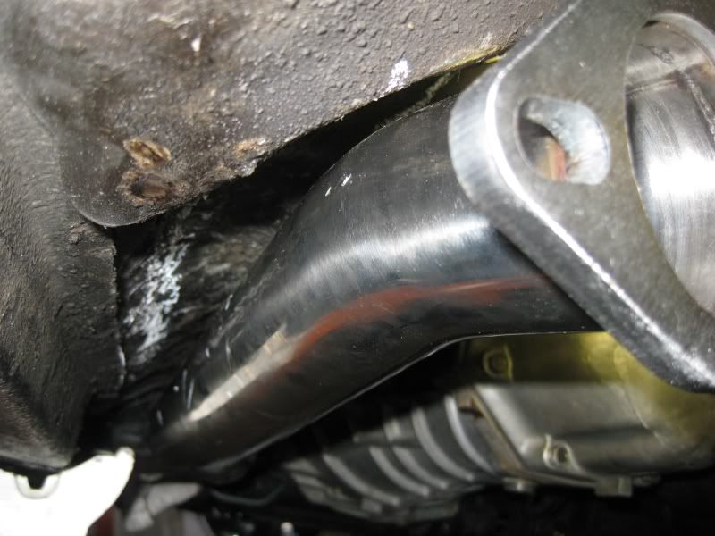

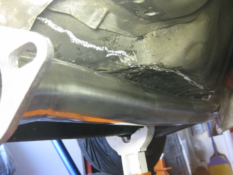

Getting an S13 KA24DE header to fit in our cars, however, is a bitch. Not because of the EGR, but because of the downpipe end. It hits our undercarriage. You're gonna need some special toys to get around that obstacle...

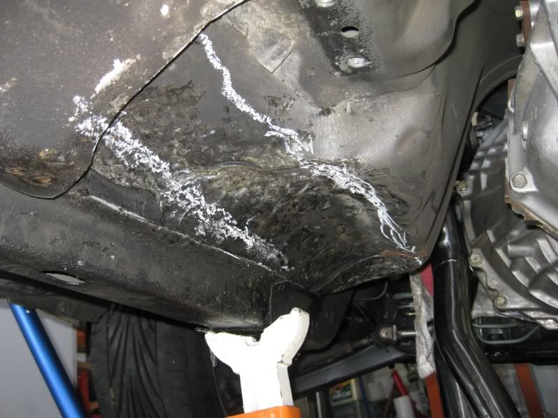

... and LOTS of heating up and pounding the underside of the driver floorpan. This is where you need to do it, and how much:

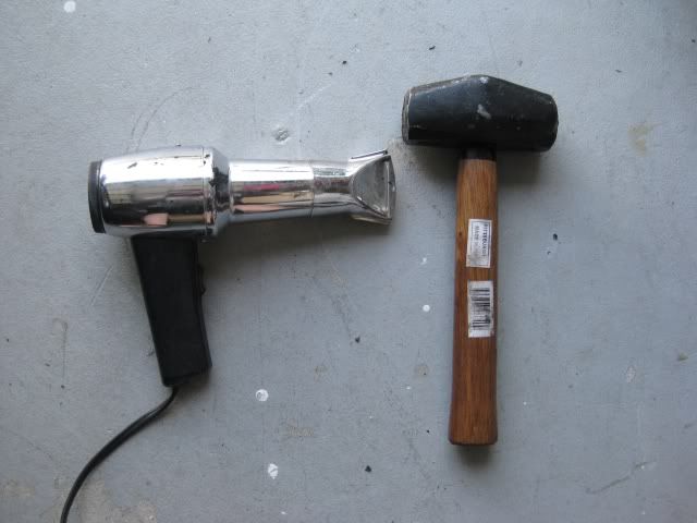

It is absolutely essential you get a 3 lb. hammer AND an industrial heat gun. I tried it without the heat gun and I got nowhere, fast. Once you heat up the steel, it reshapes much easier.
The fitment was too tight, so eventually with enough hammering, I got it with a quarter inch or more play around the entire downpipe.
Engine in, downpipe fitted and bolted up tight:

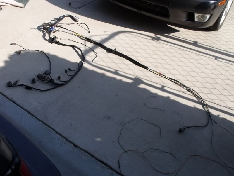

Wiring harness prepped and ready to go:

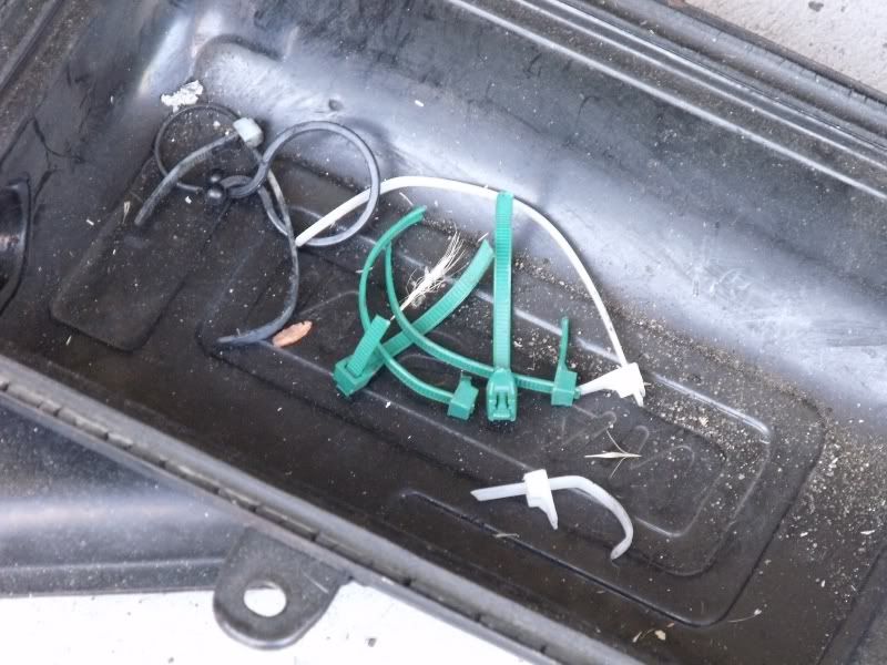

The last of the original, and another new bag of the "zipties of love", standing by.
Sacrifices must be made lol...

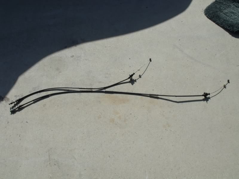

Some more interesting swap info... the CA20E throttle cable is SHORTER than the CA18ET throttle cable. The CA20E cable wouldn't reach the KA24DE throttle body. Luckily, we had the throttle cable from the now-defunct turbo S12, and used that.

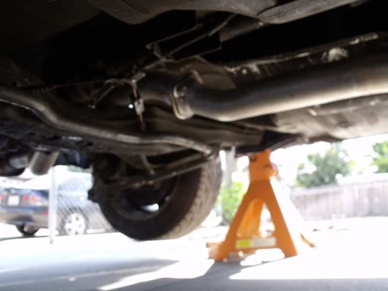

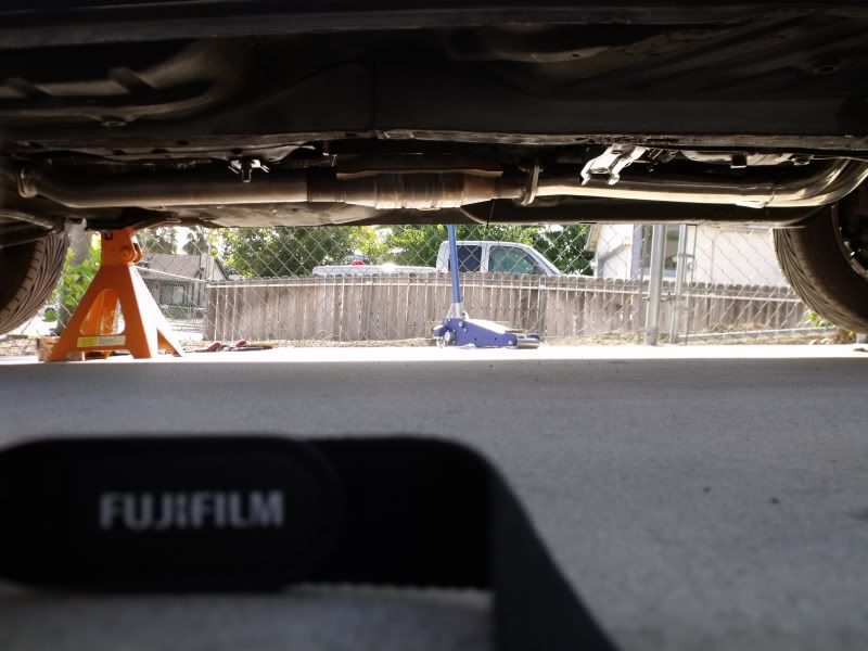

The exhaust on the old turbo S12 was all welded, but the transplanted setup uses flanges, and bolts up directly to the S13 DE header. The system is REALLY straight in path:
... and is tucked up ABOVE the unibody:
It's also completely bolt-on now, and with the way I have it, I should be able to bolt on any S13 downpipe. This is basically a legitimate bolt-on, properly-fitted exhaust.
