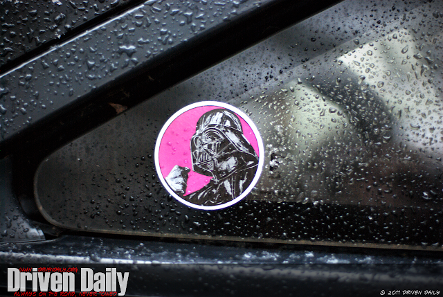

I added a sticker to it as well, which is normally something I'm completely opposed to, but couldn't resist the Darth Vader on my overly-80's-looking car.
So I suppose that's all for today. It's snowing like the sky has gone batshit insane, and we really hadn't expected it to start this early in the season, so there's wood splitting to do and plant-covering to take care of. 'till next time!
