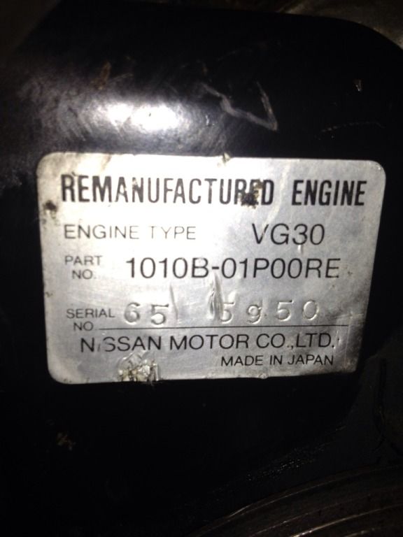

The PO had an engine installed at a Nissan dealer in the 90's, wish I could figure out the history/mileage on it.

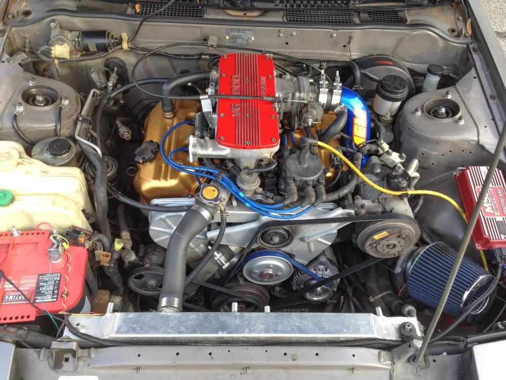

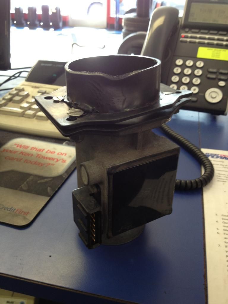

Upgraded to a Z31 ECU and MAF after I caught mine on fire:
At some point I also upgraded  to an MSD Digital 6-AL and coil, I'll post pics of that later.

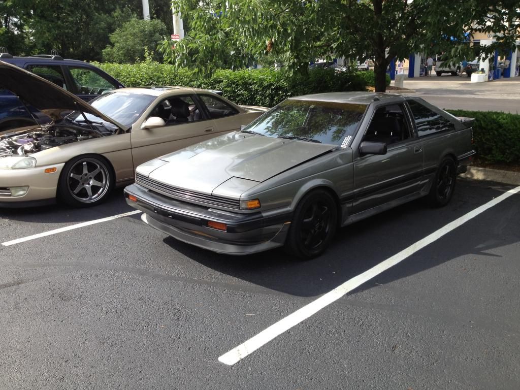

I also installed some hood risers and went to a cars and coffee event:
More to come: LSD install and valve cover painting...

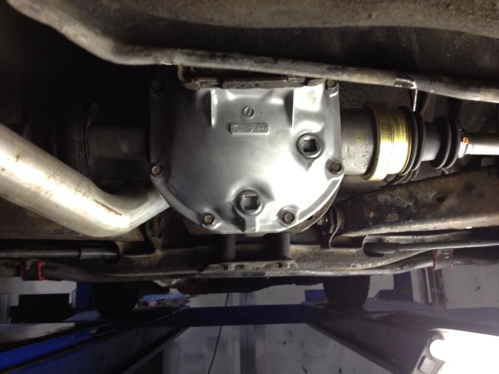

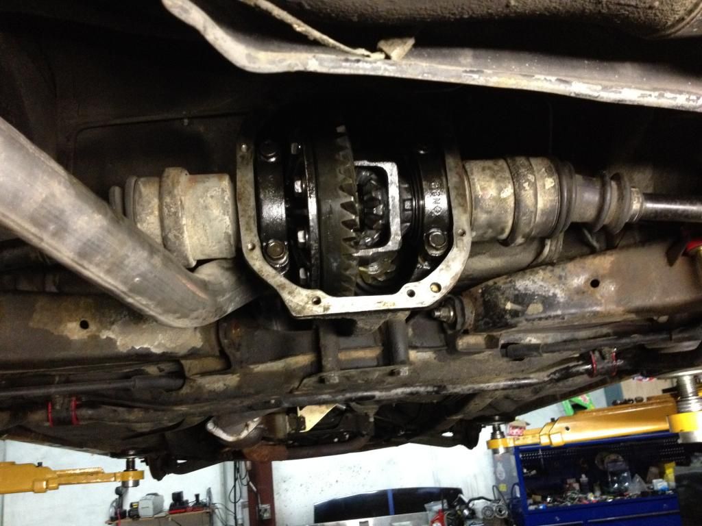

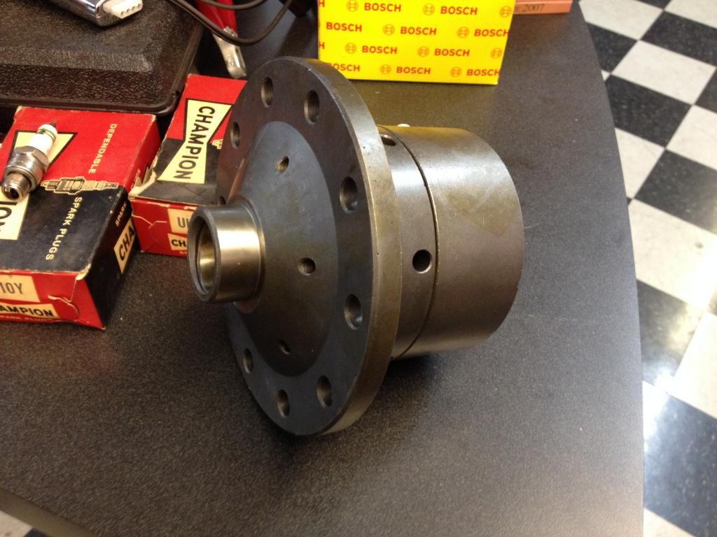

OBX Helical LSD Install:

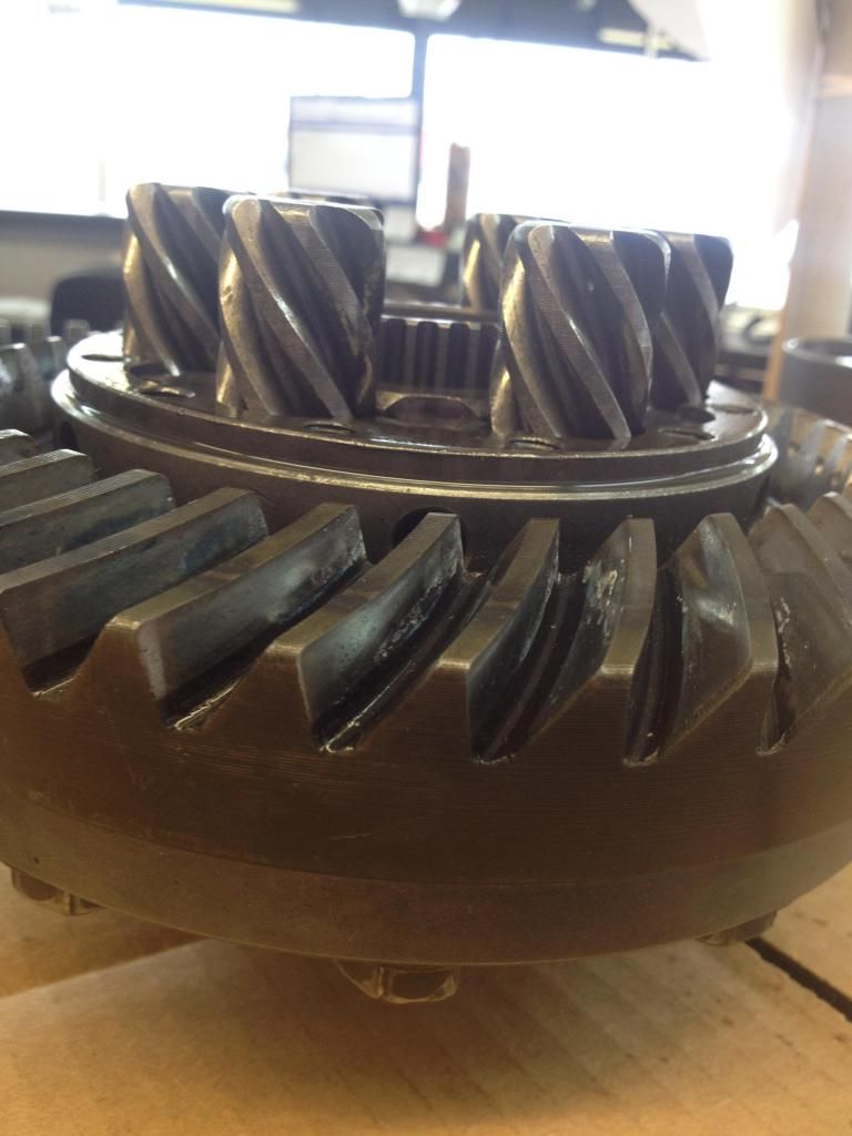

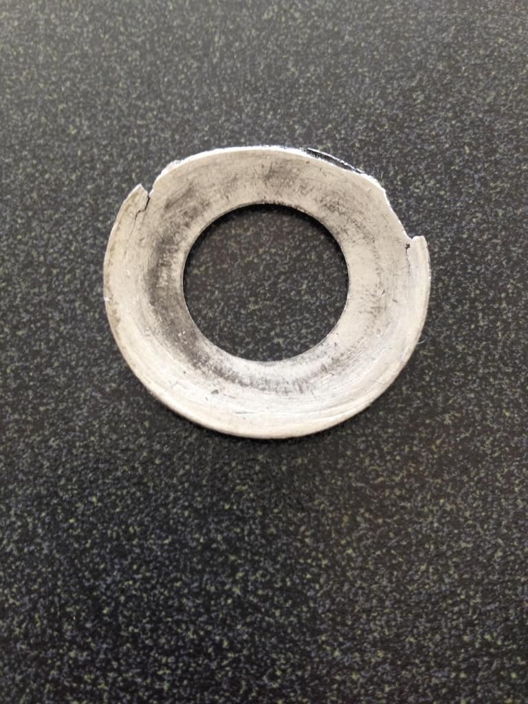

Its supposedly a Quaife knock-off and a shitty one at that. IF YOU BUY THIS DIFF YOU WILL NEED TO "REBUILD" IT AND REPLACE THE SPACERS INSIDE!!! I had to do this AFTER I had already installed it...
READ THIS FIRST IF YOU ARE CONSIDERING AN OBX: http://rbryant.freeshell.org/obx_washers.htm
New Unit:
Old unit:
I had it welded and sucked on the street:
OBX guts:

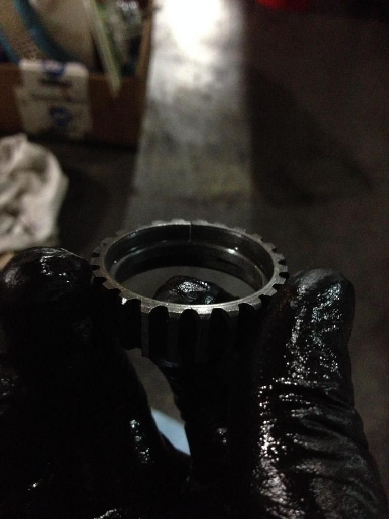

Broken belleville spacers/washers:
Broken gear in the inside, hairline crack:

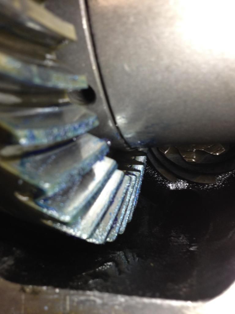

Setting up the new diff, checking with prussian blue:
Cleaned up the diff cover while I was at it, need a finned unit from a Z:
So far so good with the OBX unit, just make sure you OPEN IT UP AND CHECK THE WASHERS INSIDE AND REPLACE THEM!!!

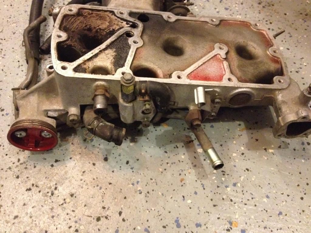

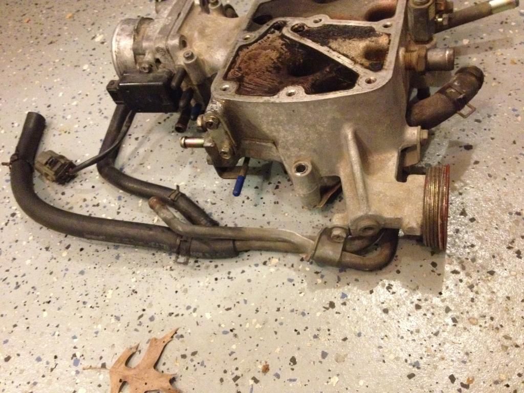

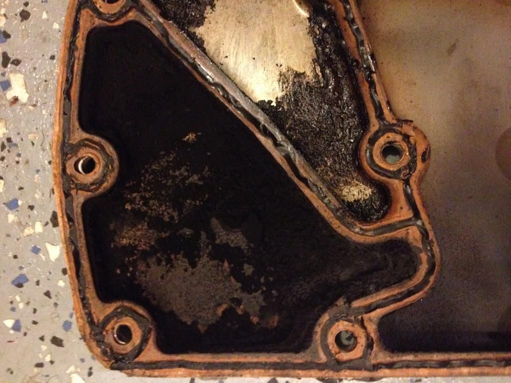

Purchased an ASCO ( Acadiana Sports Car Orphanage )  intake manifold spacer (http://store.acadianasportscars.com/in056-0002) and block off plate kit, which I foolishly have no pictures of during the install. I feel like I'm doing them an injustice because they're stuff is amazing and they are great to deal with. Check em out if you haven't http://store.acadianasportscars.com/

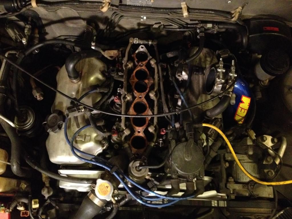

Pulled the intake:
Found a bunch of gunk:

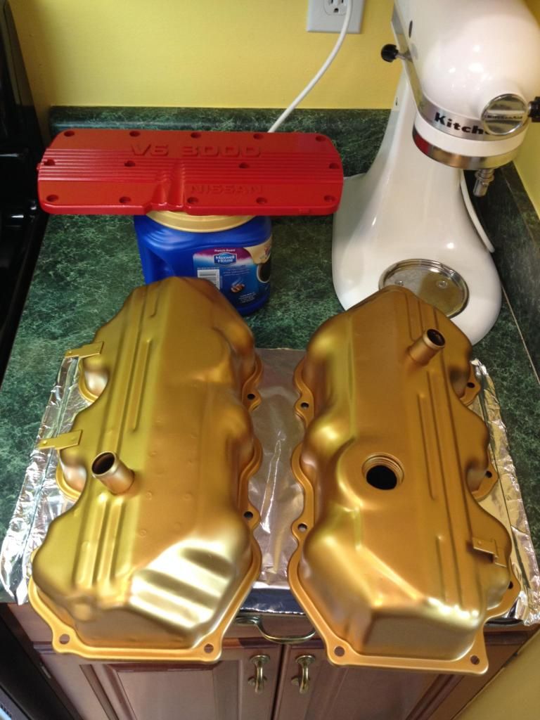

Figured while I was this far I might as well pull the valve covers and paint them...
Painted them GOLD!!!
Then baked them in the oven to cure, I'm lucky I'm still married...

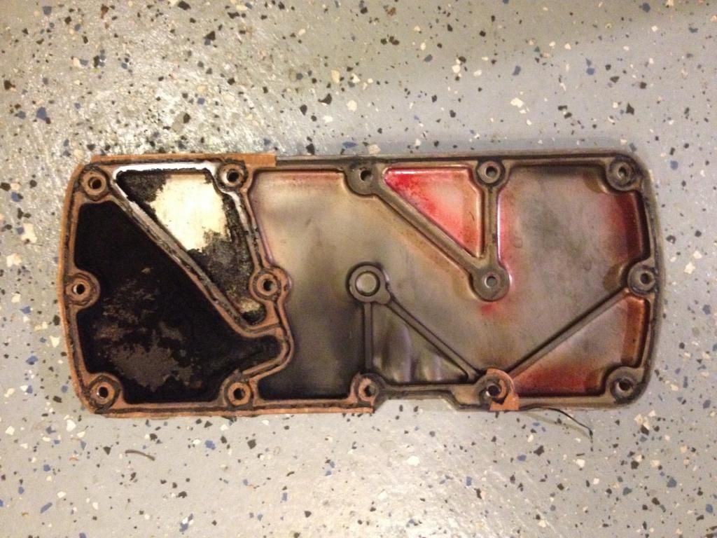

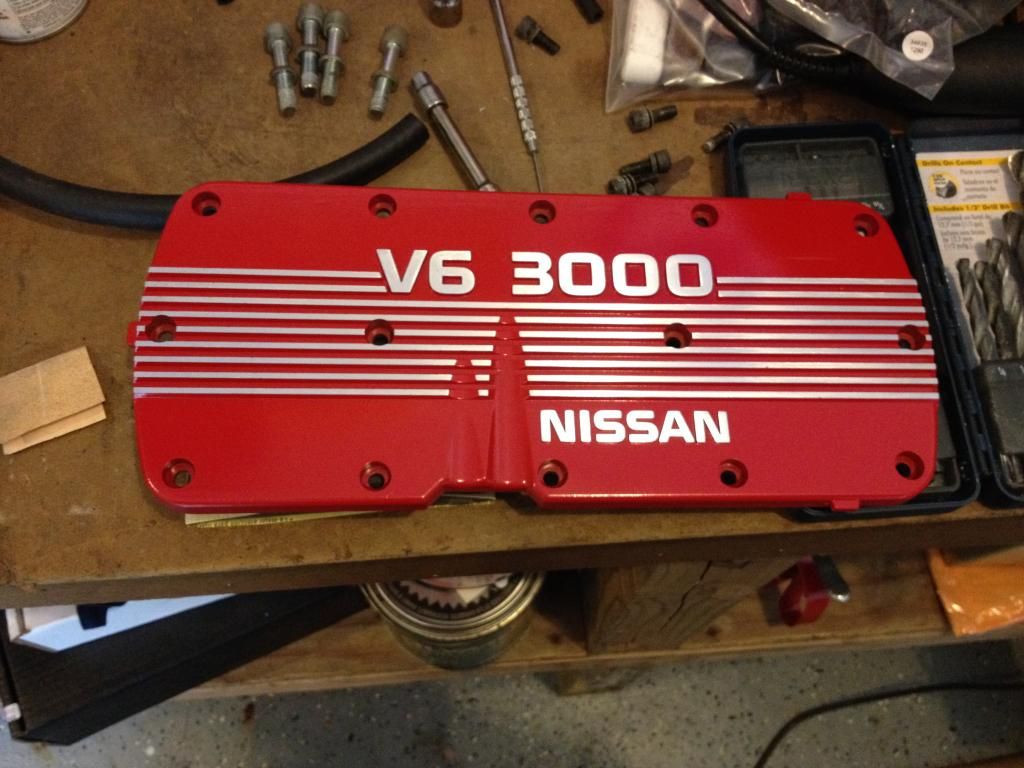

Sanded the intake top cover plate, came out VERY nice if I do say so myself:
Final product:
Look at the uncluttered intake with the ASCO delete kit.

I had to shim the ring and pinion, which was a pain in the ass. But I also played with the belleville washers to sortof set pre-load on the engagement. I'm pretty happy with it for now, I'd like to play with the washers some more but its just such a pain pulling the whole diff again.

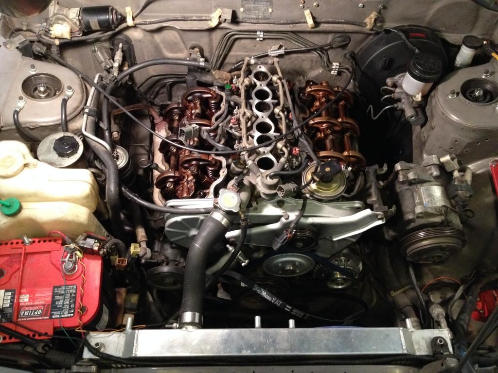

Well...another belated update. This happened on my way to work on 6-12-14.
I got about 2-3 miles from my house and was just sitting at a stop light and then the idle dropped and the car started to shake and stumble and then POOF a HUGE cloud of WHITE SMOKE came rolling from behind me. I just knew this was the big one, head gasket time. All those times I beat the shit out of the car were coming back to bite me! And I had just bought new wheels and purty-ed up the engine too! So I limped it back home and started  to disassemble it after work.
Look Ma, no hood! Always liked the "no hood" look for some reason.
Pulled the plugs. Number 1 (top right) was soaked in coolant...
My PCV had dumped coolant/water into the intake which seemed odd.
But much to my (semi-pleasant) surprise, I found a DESTROYED lower intake gasket. That was dumping coolant right into the intake.
Cyl #1
I should note I took the opportunity to delete the A/C, replace/upgrade all of the hose clamps that I could, and put on an S13 throttle body.
Unfortunately she stayed just like that for the last few months, I only recently started working on it again. My Nissan broke down on a Thursday and  I was involved in a pretty bad accident on the following Monday. I was driving my cherished and first car to work that morning, a 1978 VW Bus. When some IDIOT decided to blow through a red light and basically hit me head on. I was trapped in my Bus for 45 minutes while they cut me out, I had major trauma to my left leg/foot and as a result had to have it amputated. So I have been out of the S12 for six months now but I started working on it again and I ALMOST have it back together again.
I'm not even sure I'll be able to drive it after all of this. I fully intend to though, I may have to adapt the clutch pedal somewhat but I plan to get back to auto-x and maybe a track day in 2015.
