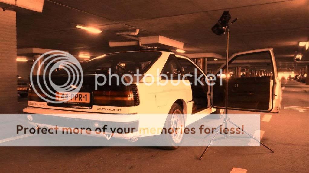

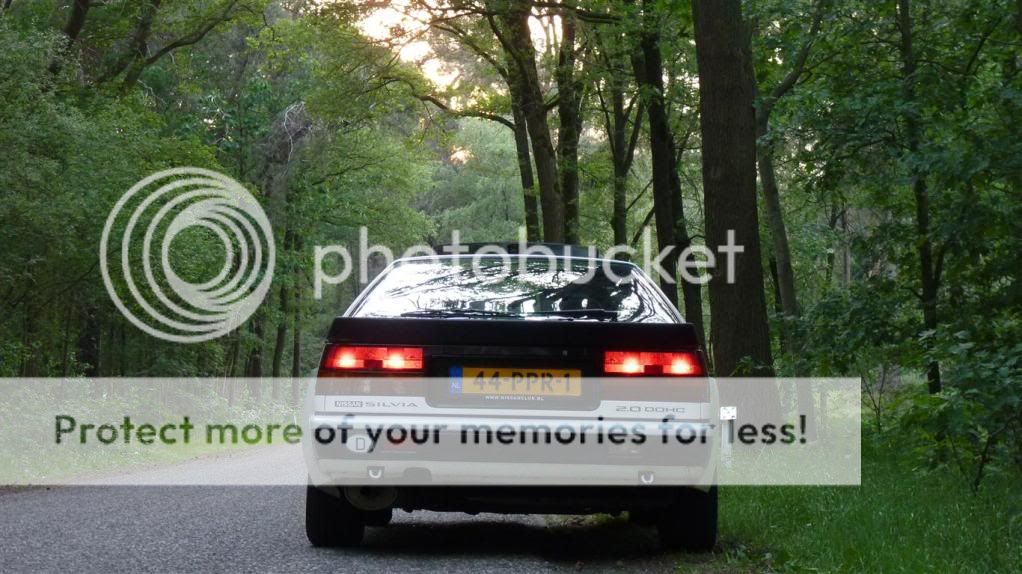

Some pictures a bud of mine took of my car.
He is also going to do a photoshoot featuring my car next month.

Hey what is that car to the right of yours in this shot?  Interesting rear end, looks sort of like a Renault...
Offline sunny1600
  • Location: The Netherlands
  • Posts: 164
Re: Marks S12 Grand Prix
« Reply #52 on: 02:19:04 AM / 21-Apr-11 »
Not really, it's not a new nissan.
A datsun 120A FII
« Last Edit: 02:20:46 AM / 21-Apr-11 by sunny1600 »
