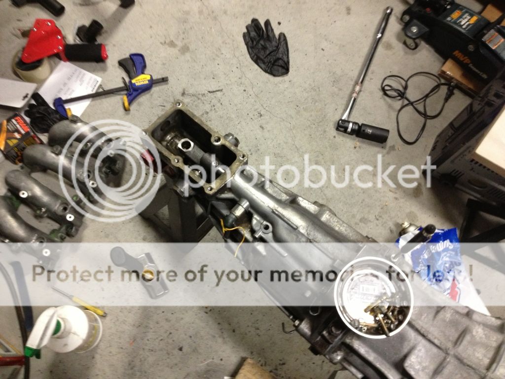

SR Trans when I was about to do the bellhousing swap
Drain fluid
The damned tail housing sealant broke loose so I had to re-seal that too.  No biggie, I wanted to inspect the gears anyways.  I didn't get a pic of that part though.
« Last Edit: 03:29:56 PM / 27-Nov-12 by 8SixS12 »

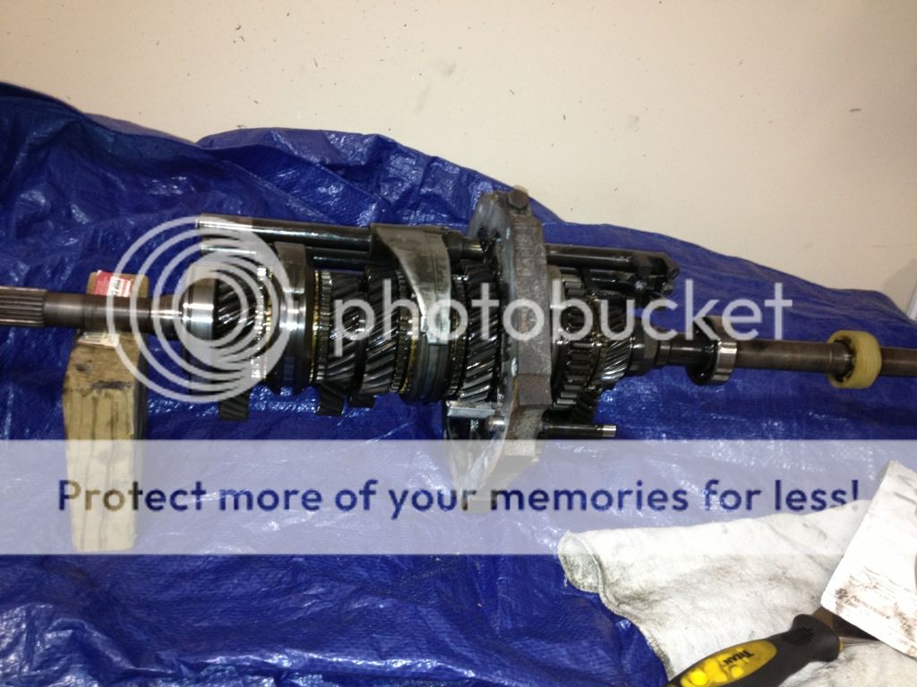

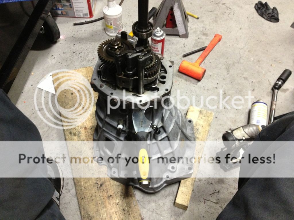

Got the BH swap done but I had to pull the tranny back apart...

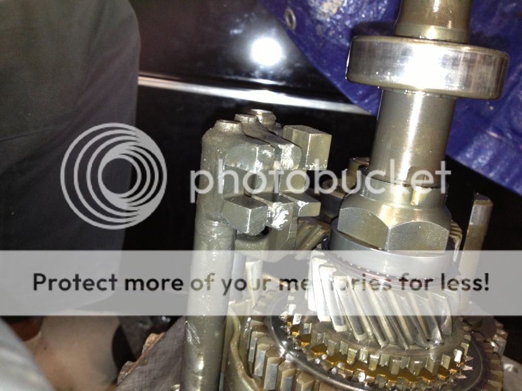

I forgot to put the shift forks into neutral  >:( Might as well inspect the gears....
That's what happens when you have to stop and start and stop again.  Chaps my ass!
Anyway, the gears all look good so back together with this ish!

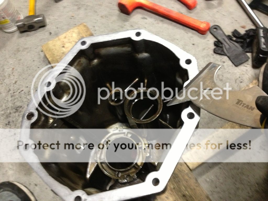

Off with the new old gasket residue.  Used a scraper and fine grit wheel on my drill and all the mating surfaces for a tight seal.
Got the damned forks in neutral...
