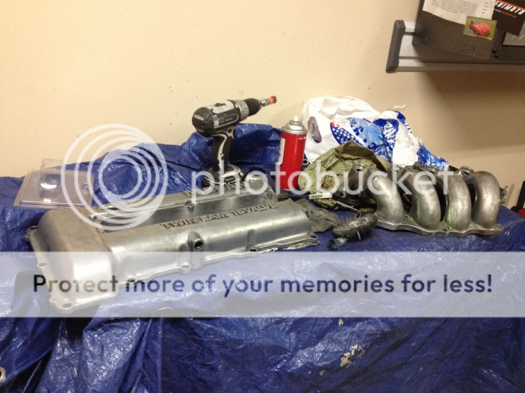

Believe it or not, I plan in using the oem intake and exhaust manifolds to take advantage of the new cam profiles and to save some funtickets in the process.  With that said I wanted to try out this new paint from KBS coatings. They are a new vendor that just got picked up where I work.

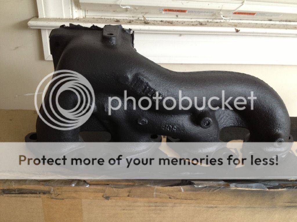

I talked to the reps and they say the spray will withstand about 1200 degrees and it won't peel or flake off.  I sprayed my exhaust manni with it and it looks like it was powdercoated.
I did have to hit it with a wire wheel to get all the surface rust off first and then wiped it down with some TSP to remove any left over oils and dust before spraying it.  Then I baked it in my barbecue grill @ 300 degrees.
I'm not a great painter but this thing has zero runs on it.  I think it came out pretty decent for a spray coating.
I'm thinking of doing the same to the intake manni as well but I'm not sure on the color scheme yet. You can bet it won't be blue, green and white though.
I'm almost done prepping my intake manifold and valve cover.

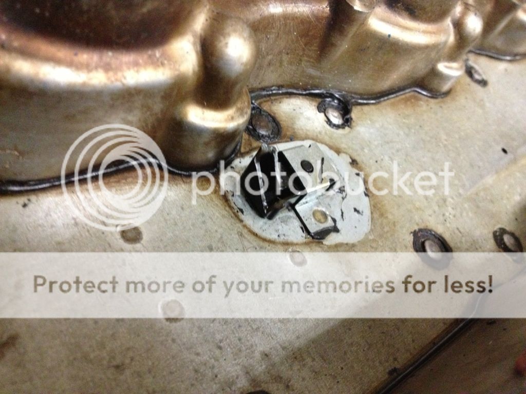

Problem is I just noticed that the baffle drain (Or what ever it's called) on the underside of the VC is broken.
Not really sure if it matters or not but it kind of makes me uneasy about using it. I found another one though but it sucks that I wasted all that time and energy getting off that ugly blue powder coat. BTW, CRC gasket remover works wonders on powdercoating. Spray it on and let it sit for a few then wipe it off - no BS! I used a platic scraper to avoid gouging the VC.
