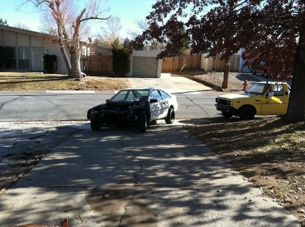

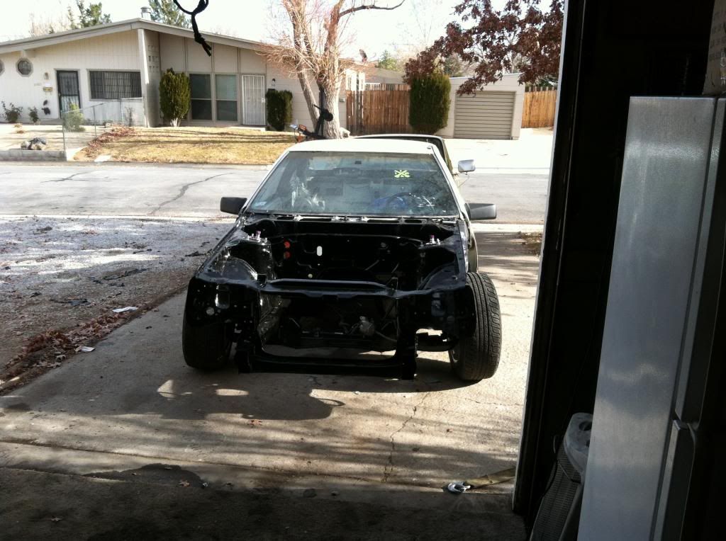

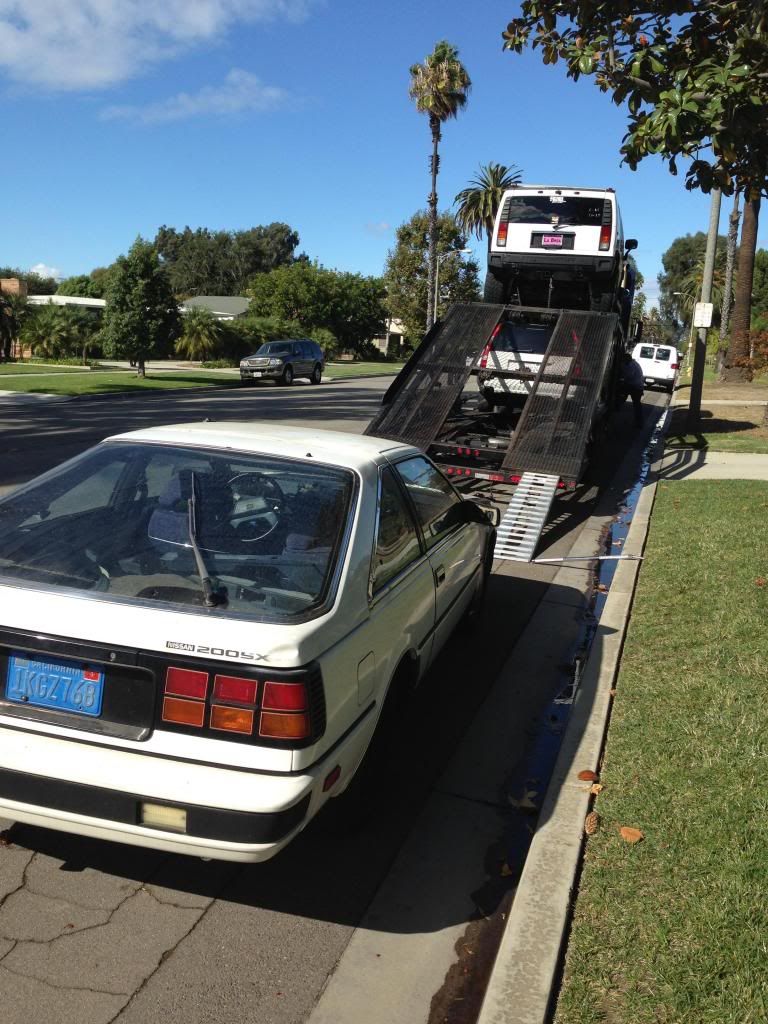

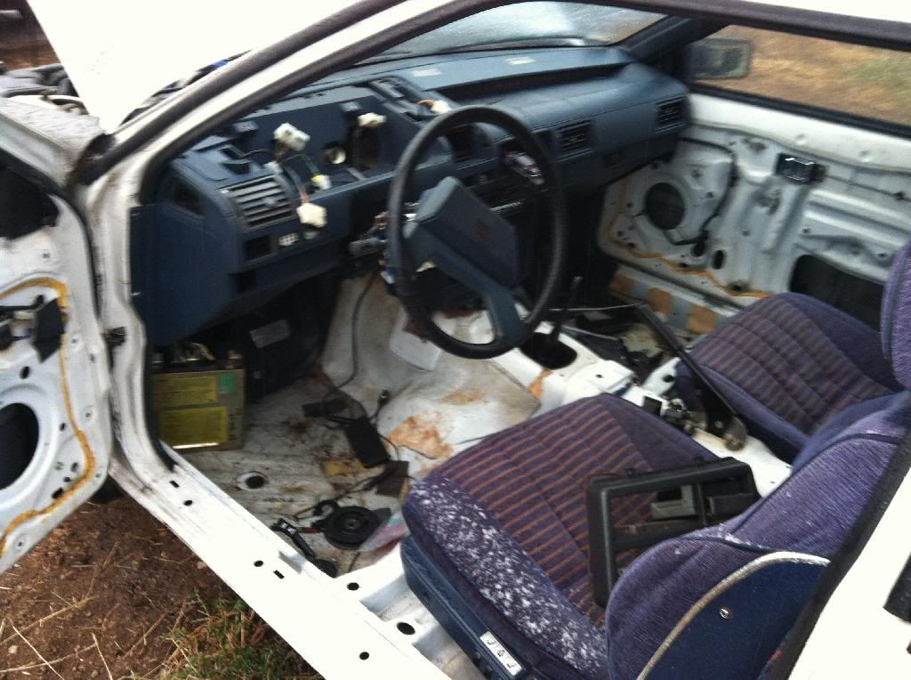

          Taking its place is a 84 SRA s12 I bought and shipped from long beach. Everything that's on the 87 se is getting swapped over to the 84. still going to be rocking the ka24de. fully gutted, anything not needed will be removed.
          With the start of this build. I want to do something different, instead of updates with pic's, I wanted to update with videos. there still will be pictures. but most updates will be videos (even though I sux on camera lol). Also would like to use my Instagram for updates. My Instagram account was created for this build and track events the car will taken to. So if you follow my Instagram your not going to see pointless updates of my life.
Instagram user name: @BoxeeDrifter

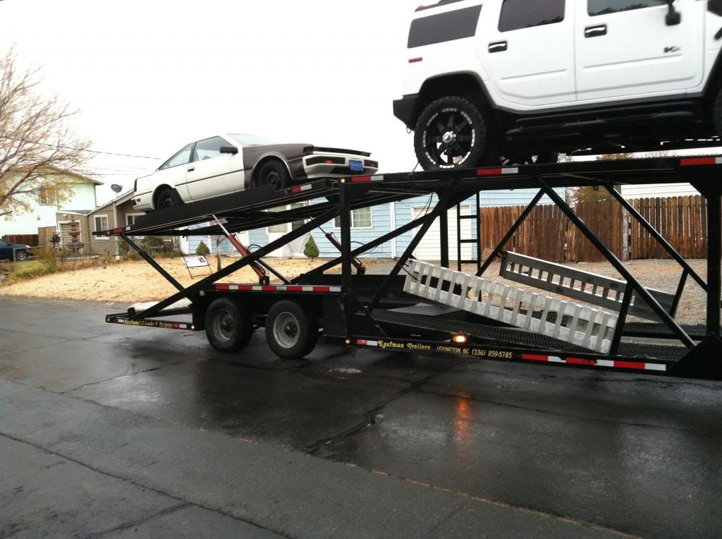

being loaded up
loaded up
Almost home

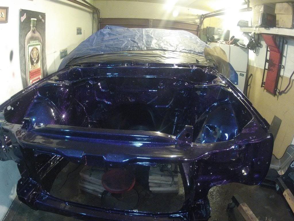

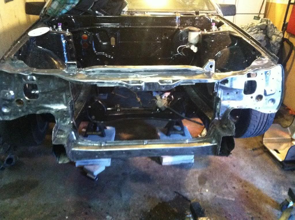

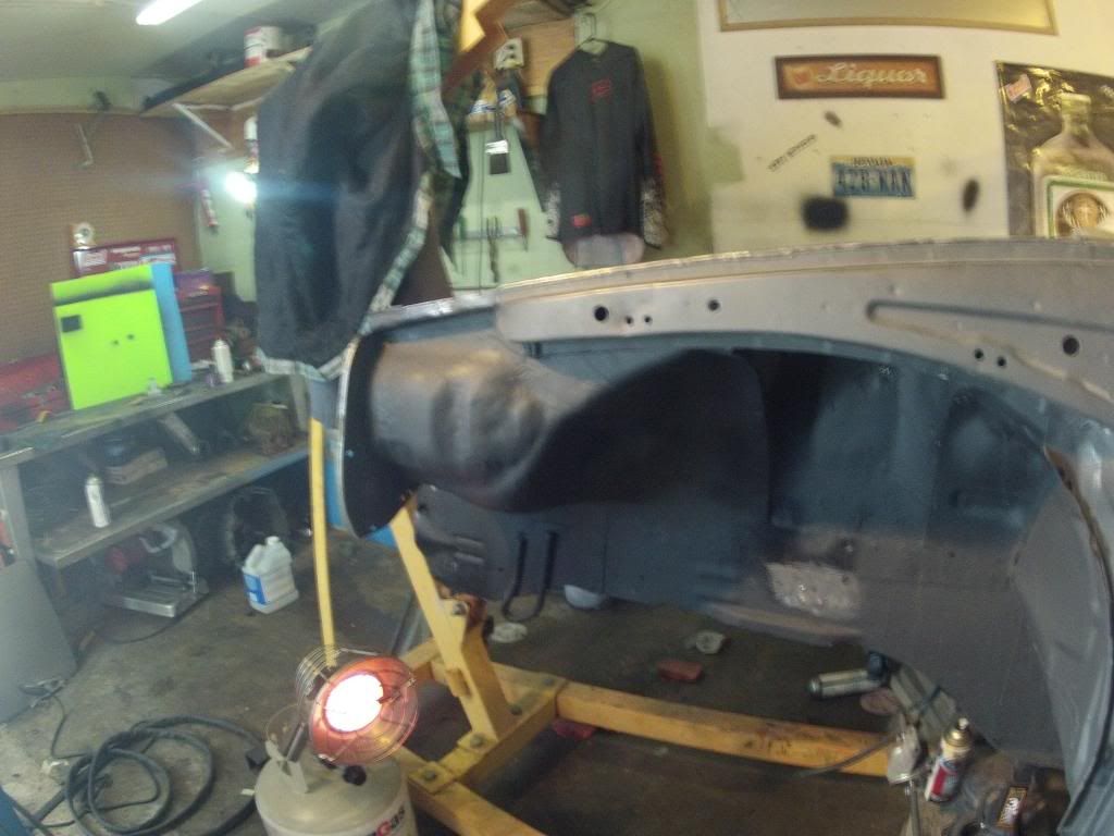

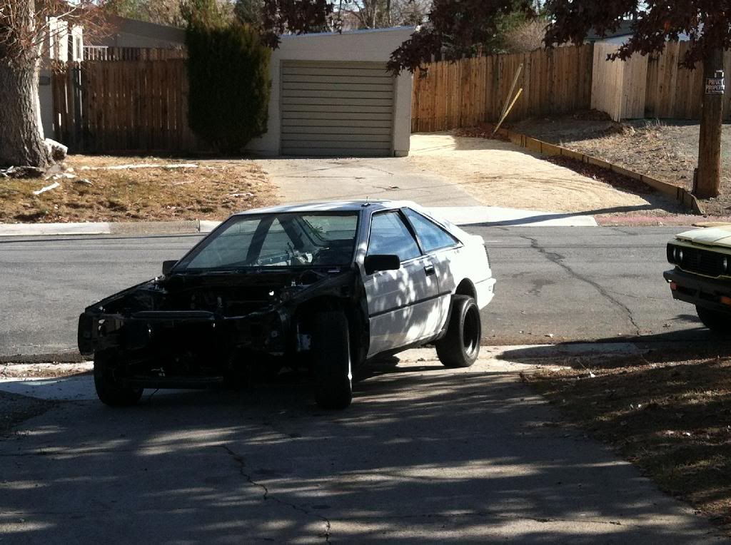

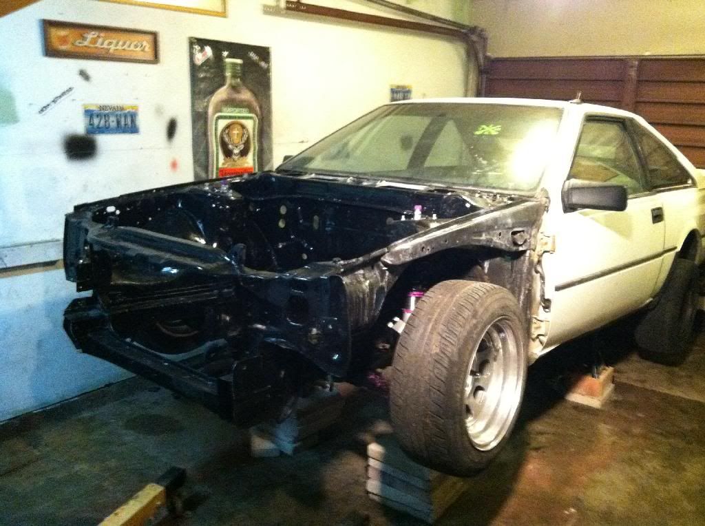

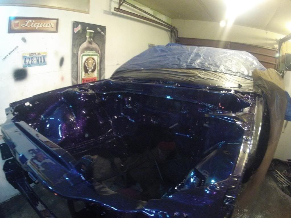

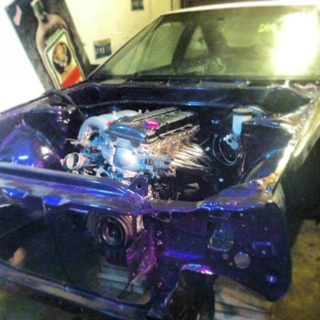

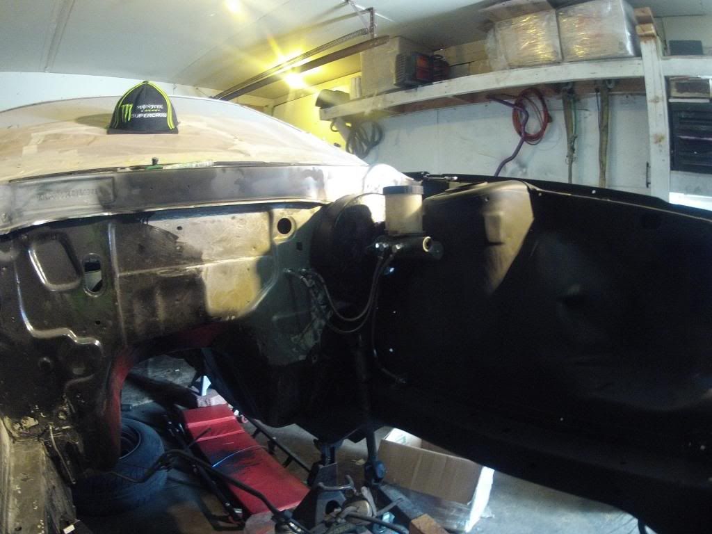

sitting on coils for the moment. POR 15 on the engine bay. didn't come out well, cuz I did it in a low temp. im going to fix it later.

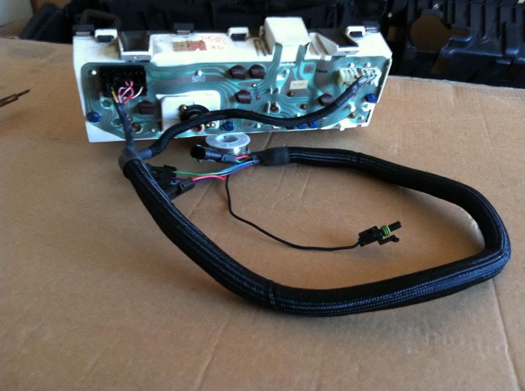

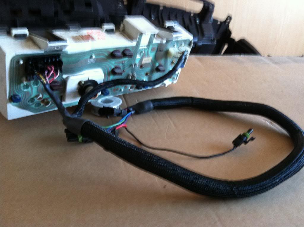

Some wiring
cluster harness
details: waterproof plugs, braided sleeve and shrink tubing

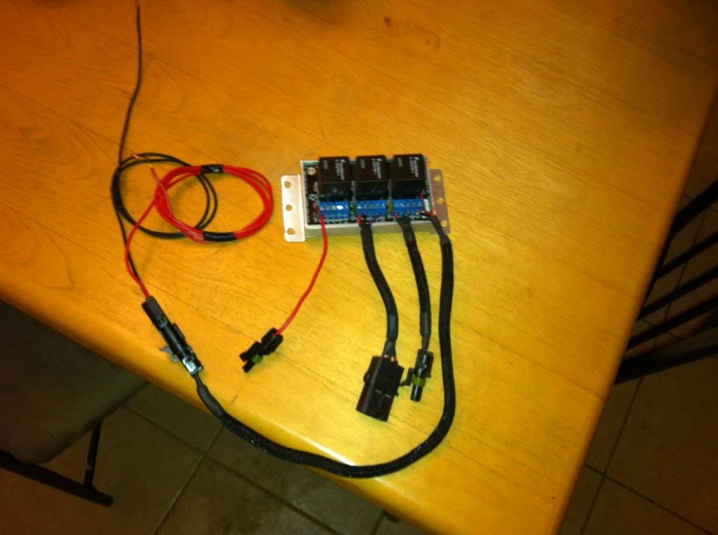

Can-am EFI relay box

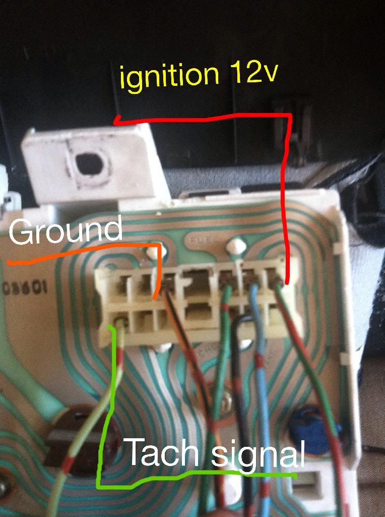

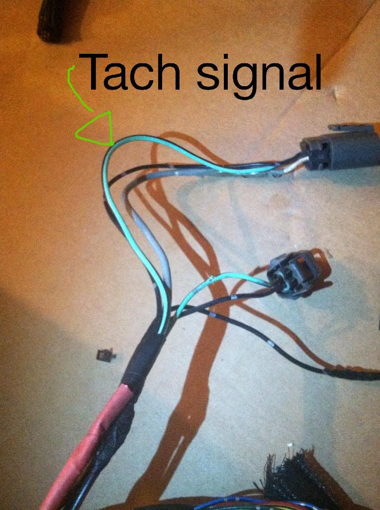

here is how I wired up my MKII cluster to the ka24de.
DONT PAY ATTENSION TO MY WIRE COLORS. THEY ARE WRONG.
I had to de-pin the plug because I cut the wires to short.
but I took picture of the plug and use paint to label hole on the plug that you need to tap into to get your tach to work. if your just doing a swap and not doing all your own wiring like me. then you shouldn't need to worry about the 12v ignition power & the ground. the stock harness should supply power & ground.  but if it doesn't work you might want to check to see if your getting power when the key is on to the 12V ignition & ground
*****see picture #1
the wire on the KA harness you need to use is the light green/black wire. there's a resistor next to coil wire that you can tap into. the resister is not needed. I removed it. on my s13 and it did nothing.
***********see picture #2

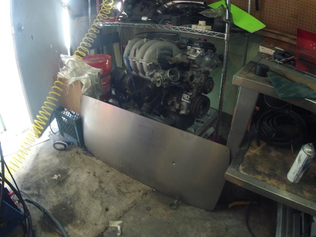

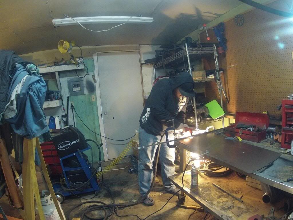

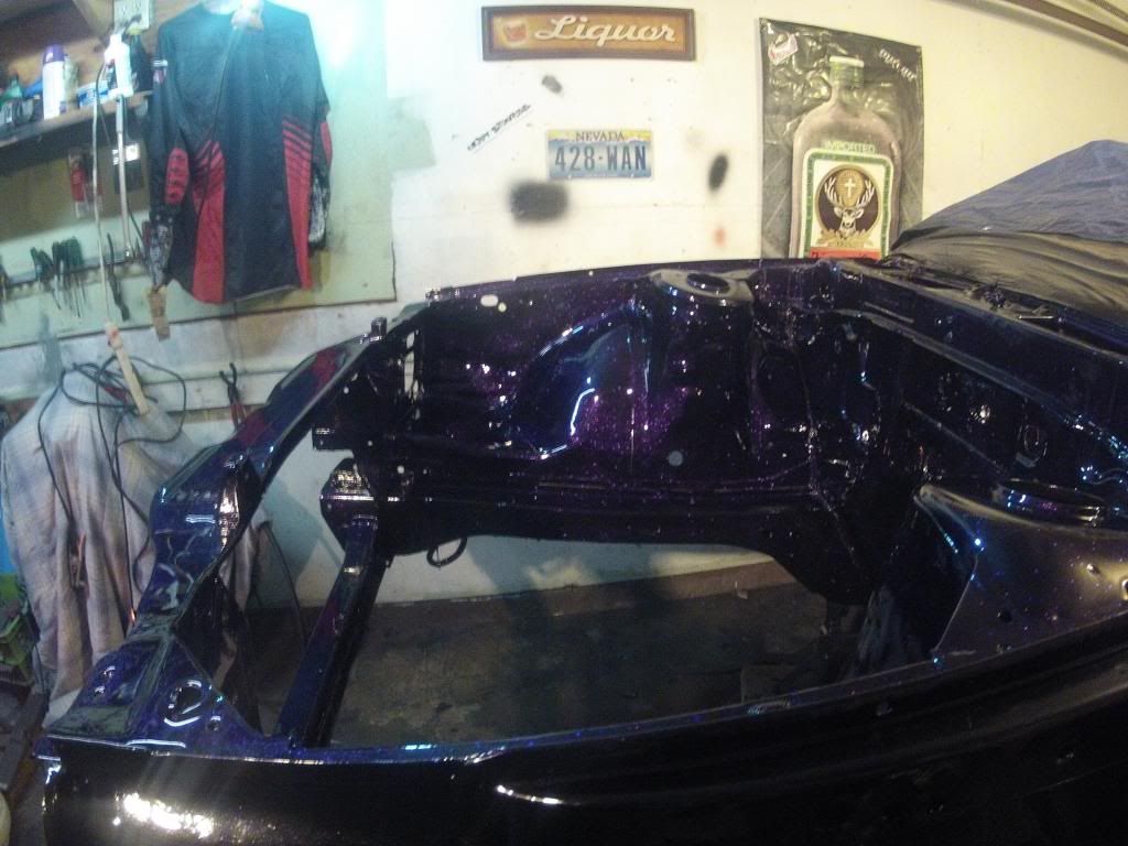

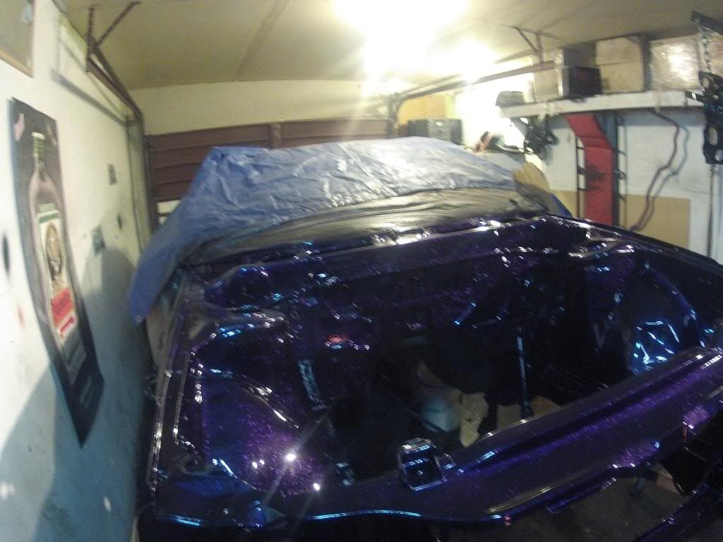

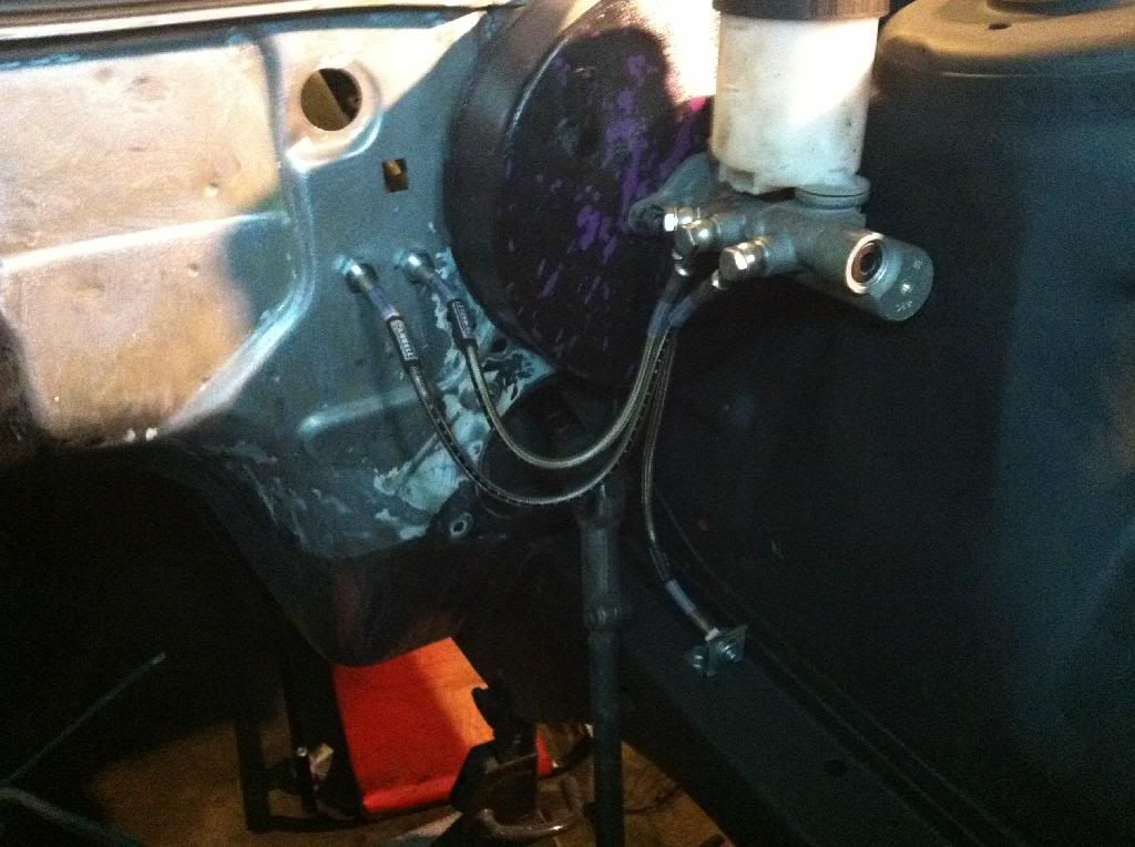

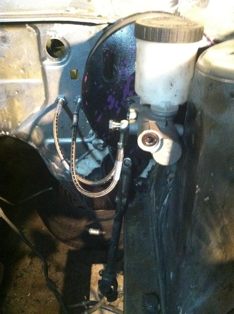

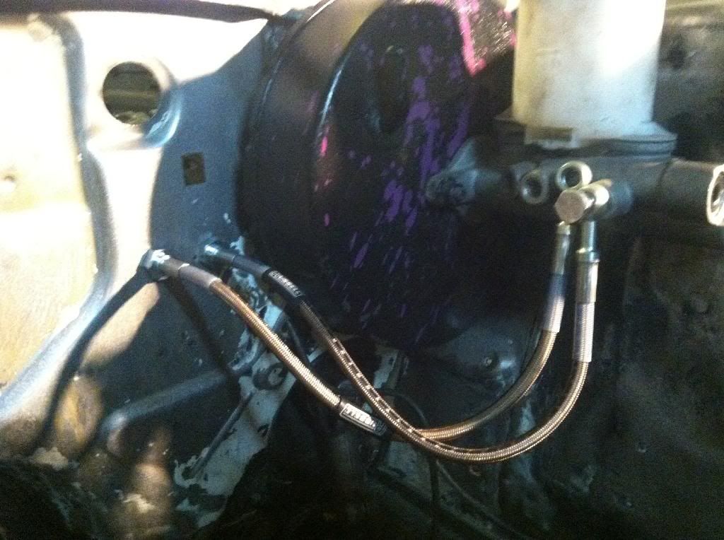

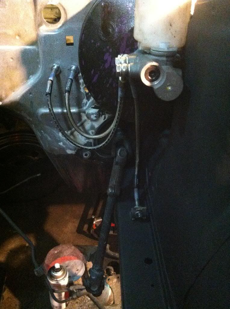

making good progress on the brake line setup. pretty stoked on the way it came out.

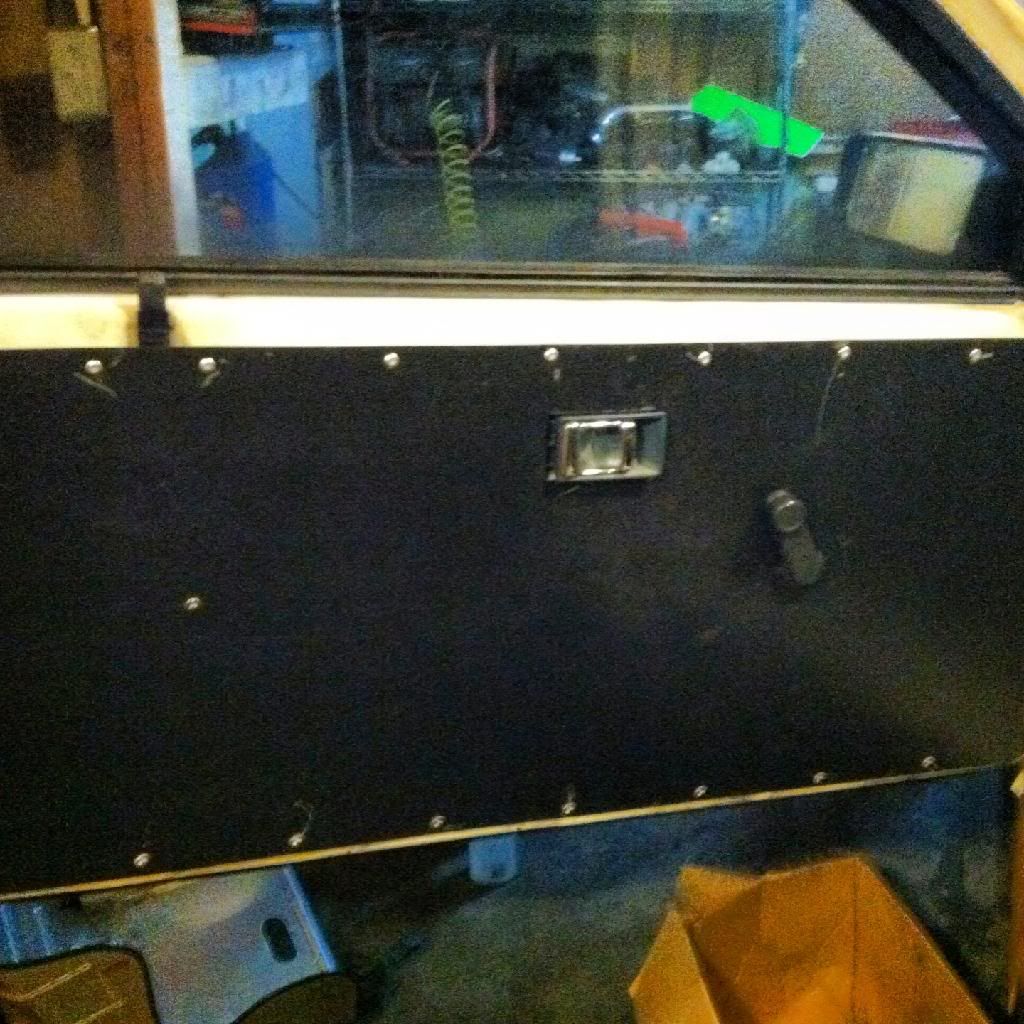

I used my new plasma cutter to make some sheet metal door panels came out pretty good in my opinion.

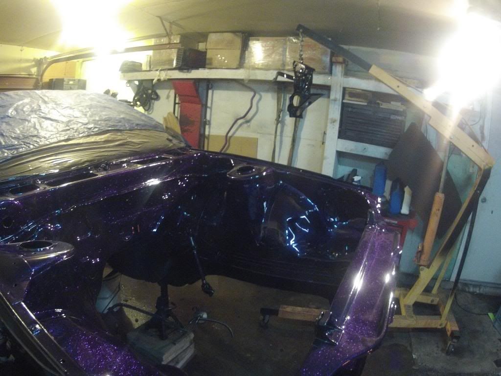

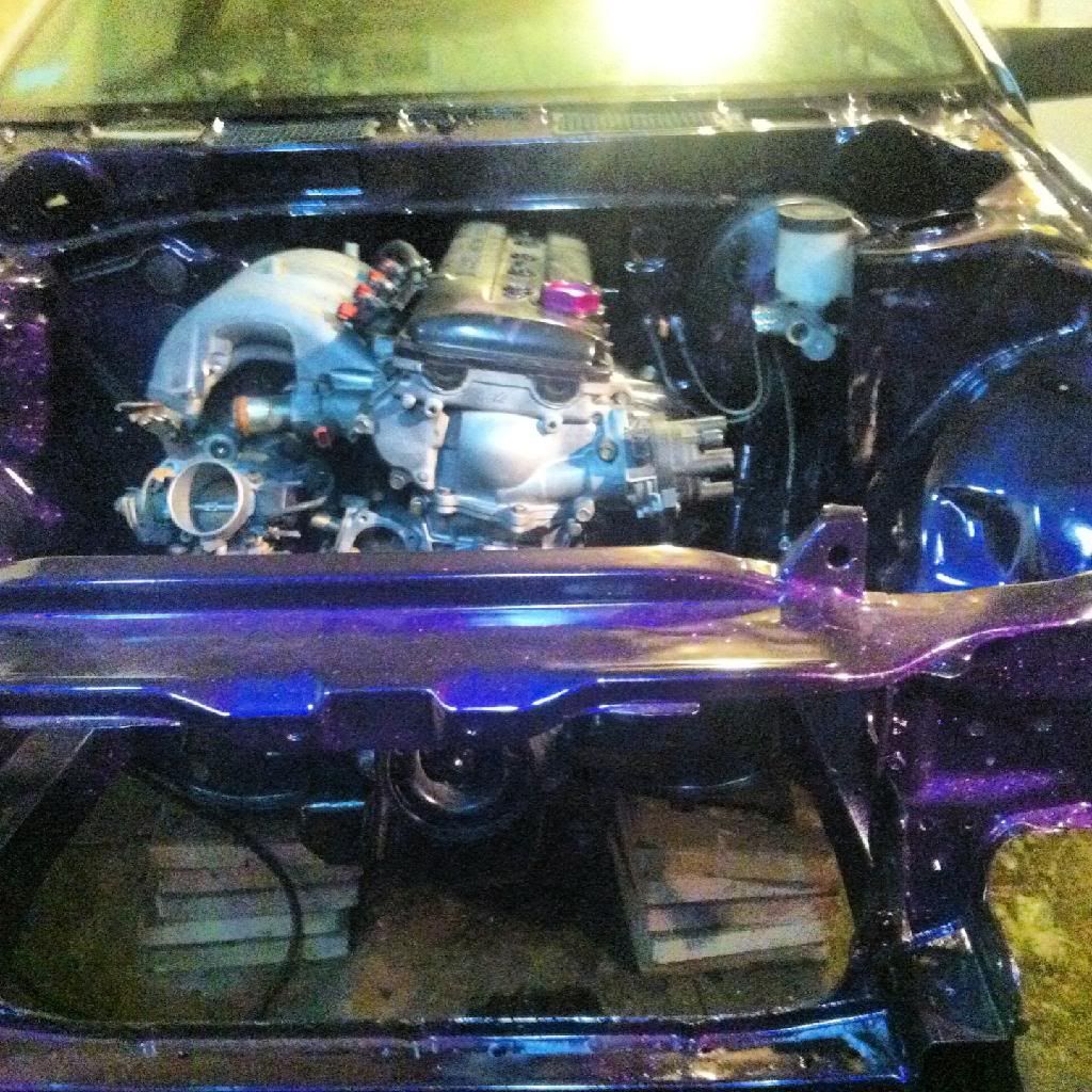

picked up some paint for the engine bay. got some black paint with roth purple flake, should pop

« Reply #5 on: 11:10:19 PM / 12-Jan-14 »
damn thats a legit plasma cutter. nice work

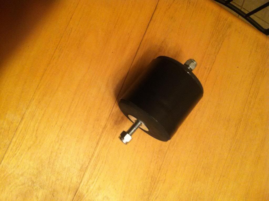

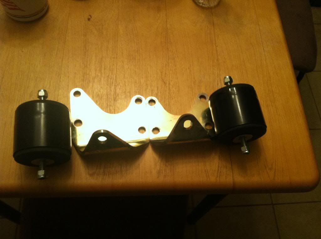

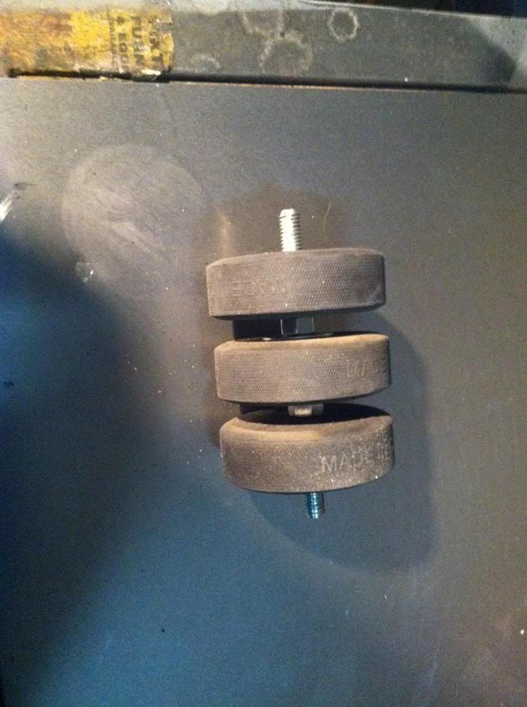

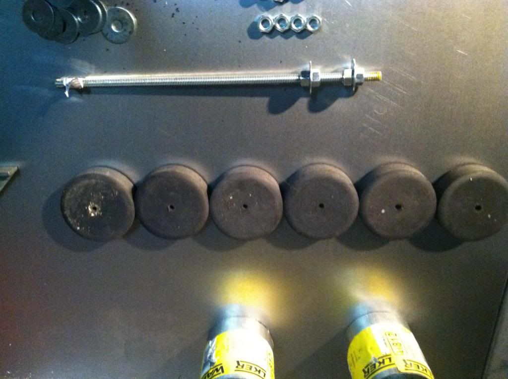

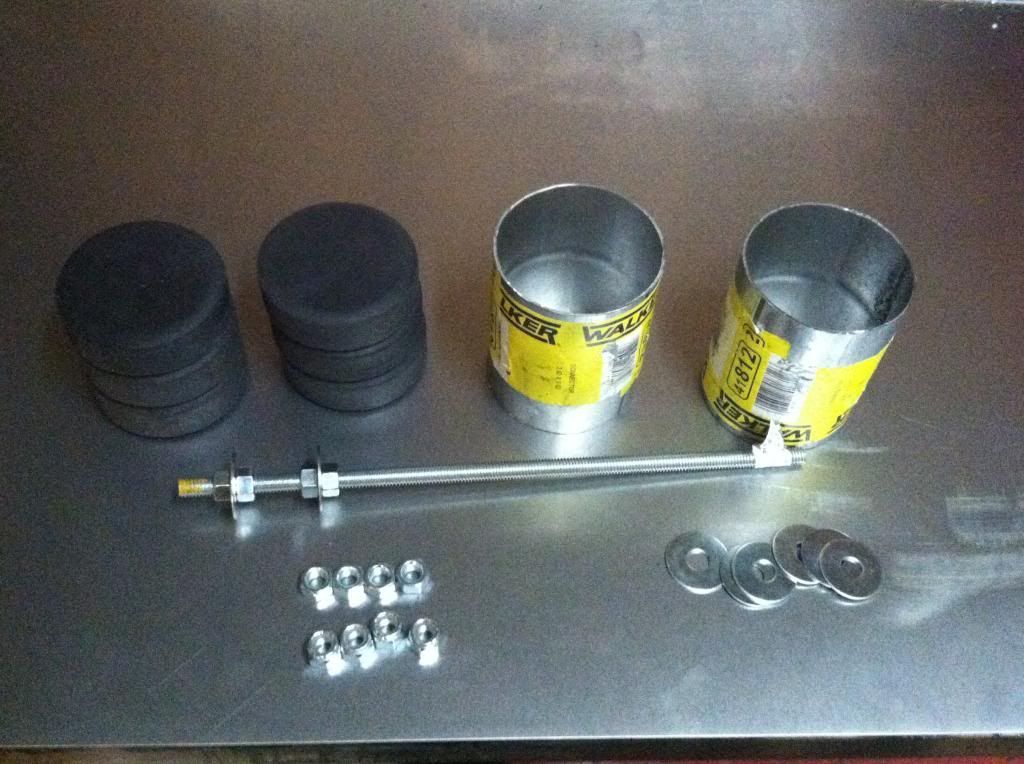

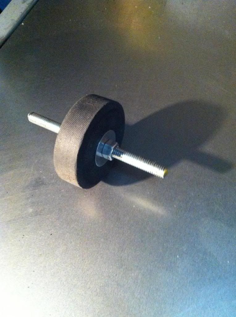

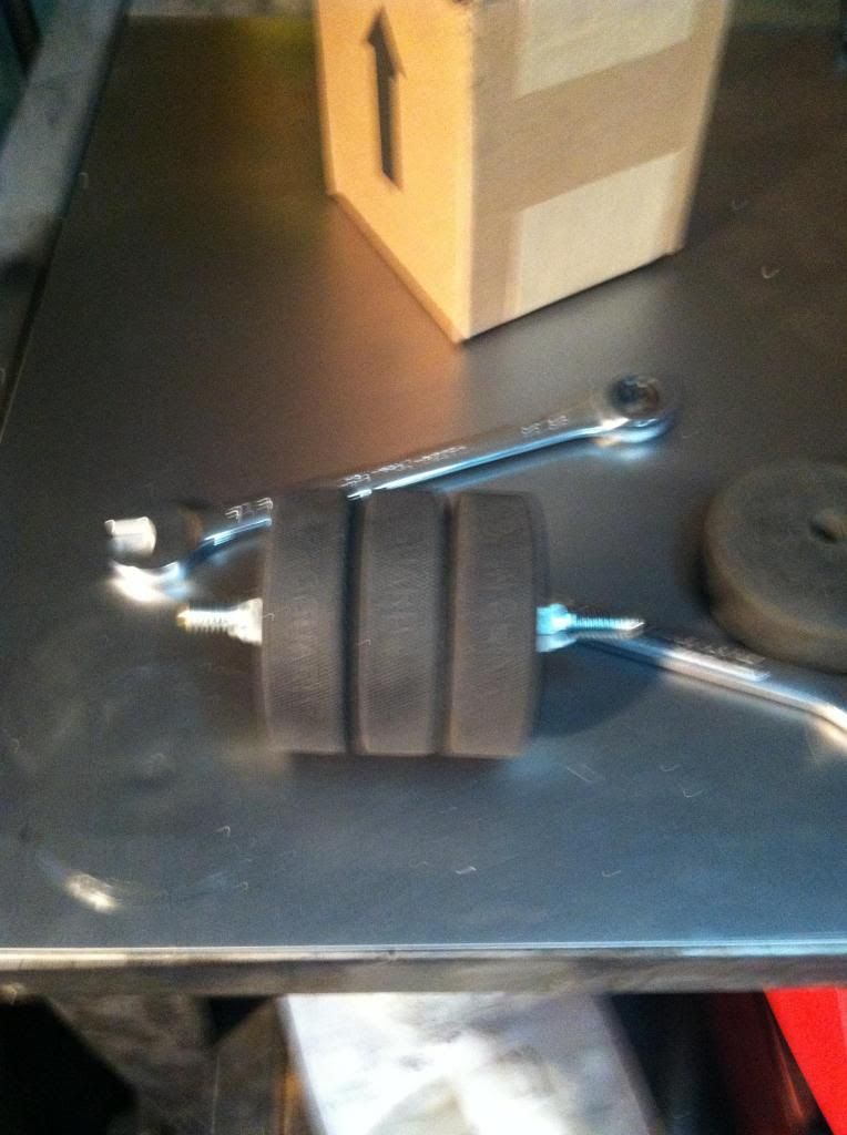

worked on my hockey puck motor mounts today.
Parts
6 hockey pucks
3in ID tubing
3/8 threaded rod
8 3/8 nuts
8 3/8 flat washers
4 nylon locking nut

awesome color in the engine bay and even cooler ghetto motor mounts :sleezy:

Thanks the mounts came out pretty good.
So I was a lil worried about using 3 pucks for the motor mounts. Cuz everyone I've seen uses 2, but it worked great. It sits where it would if I used the stock ka mounts. But I did use lowering motor mount brackets. Thinking about trying 2 if I can't clear the MK1 hood with three.
So I also found out the my se tranny with the ka bell housing is 1/2 longer then the b tranny. So now my driveline won't fit. So either I need to switch over my ka bell housing or get the front section of a MK2 drive line
