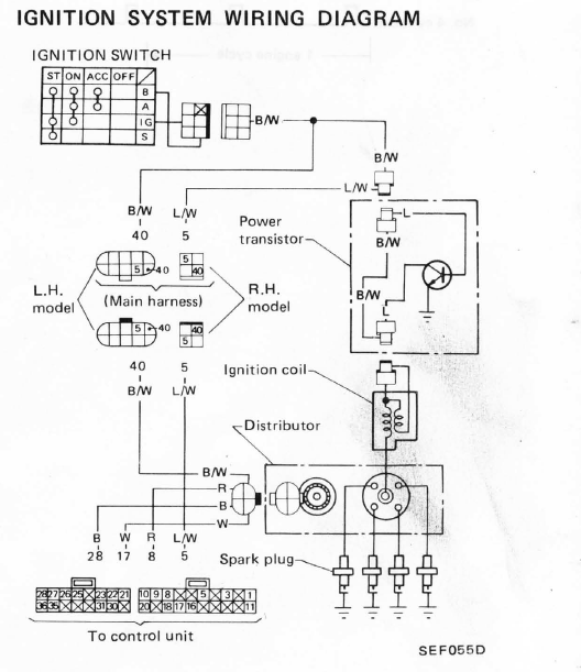

2nd issue is I get intermittent no spark when starting up and it did cut out on me a couple of times when driving at operating temperature too. I checked ECU codes and it kept throwing 21 for ignition. Took the multimeter and traced the wiring and checked everything which was fine but it still kept throwing code 21 even after clearing. Replaced the ECU with one from my old et setup from my other s12 and it no longer throws the code but I still get intermittent spark when starting up after a drive.
According to the FSM: (Check out my pb for pics of my s12s)
Both the dizzy and transistor should be connected directly to ignition from the barrell but when I checked continuity directly from the barrell to both, only the transistor showed continuity to ignition and not the diizzy?! I tried to jump ignition from the transistor to the dizzy but that just turned the ignition on permanently without having the key in ignition position which confuses the hell out of me. Is there a sperate relay to give power to the dizzy?
