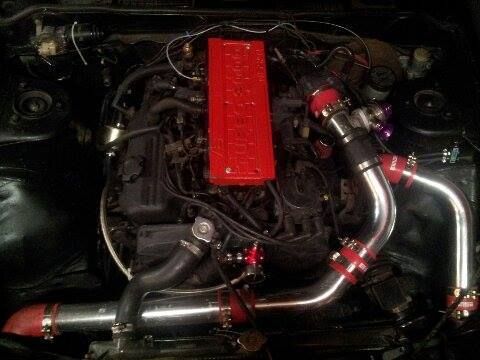

   So, I'm a new guy to this forum, I figured why not get the introduction out of the way as well as start the build thread. I've been working on it for a few months now so there is a lot to primarily cover, but first some information about me. I'm a 21 y/o LPN who would rather spend his hours in the garage working and or welding things for no apparent reason. I pushed myself into the medical field for money but it's not what I have passion to do. So of course I every minute I'm not at work I'm where I love to be. I've grown up restoring cars with my dad, currently we have our 41' Special Deluxe which is sort of a father son joint project that will never end undoubtedly. A 79 Firebird I'm stripping and caging at the moment and my 87 200SX. His daily is boring so we can avoid that. So Anyhow without further pointless rambling here is the Jalopy I received from the Sticks of PA. I Actually traded my MK1 Supra I was in the process of restoring for the S12. I wasn't about the large boaty car, although it was pretty cool to have one of the only few going to meets around Pittsburgh.
       This is exactly how I got the car a couple months ago, hardly running. (Looks are very deceiving) A very poor Vg30ET swap into a CA Model. Previous owner left both wiring harness and a boat load of unnecessary things, rather than properly splice the existing harness or make his own he decided to create this ungodly mess I'm about to show you.
 I knew what I was getting into, and I was practically unphased of the magnitude of the project until the drive shaft bolts failed halfway home. He also used the wrong bolts, with no washers, or lock washers, or rubber insert bolts (The ones that help with vibrations.) Tow Truck call 1 shortly ensued.

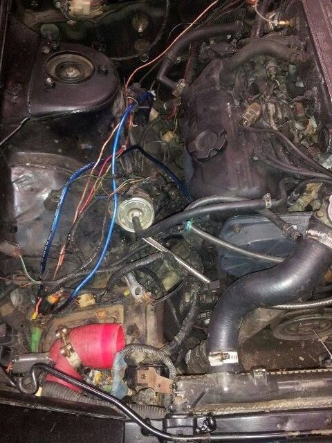

As you can see, the retarded amount of wiring that was done in the engine bay. Notice the exposed wires, lack of wire looming or even electrical tape. I was surprised it even started when I first saw it to be honest.
Here is after I relocated the unstrapped down battery, relocated the coolant tank, Removed any unnecessary wiring and tucked the looms. I maybe had an afternoon in the whole process. During this time I also did both manifold Gaskets, Coolant reroute to avoid the Mani and Intake Valve Cover gaskets and any other misc Stuff. Deleted what didn't need to be and moved on.
The valve covers and intake manifold are both Wrinkle black, because Ferrari.

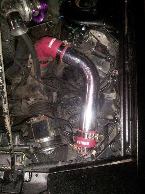

I also Added the 1:1 AFPR, which I decided it was easier to weld the bracket for it to the timing cover while I had it off, keeps it in a nice tidy place. I'm not sure why but you'll notice my fuel filter is actually in my return line, if that goes to show you the mental integrity of the previous owner.
The interior is pretty alright, I know you're asking right now where is my cluster. I have a CA 200sx cluster and a Vgz31 Cluster and choose to use neither. My GPS covers my MPH, I now have a ridiculously huge Sunpro Super TachII On the dash, and of course all of the other gauges to monitor engine/ouput. And my radio is indeed mounted there, and it does fully function. The door cards are Luan wood, wrapped in some random fabric I found at Walmart, I rewired the driverside master switch and its now located Miata style on the center console.

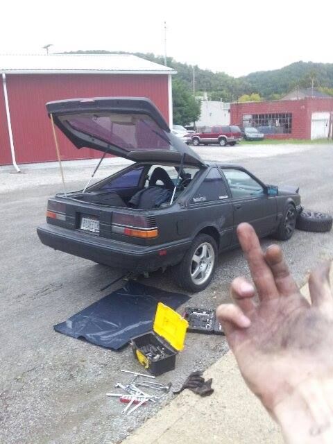

My CV Bolts also broke, recently. Did not make for a fun morning while I was changing them out on the side of the road at 630AM.
Here's the skinny on the car currently.
Vg30ET/FS5R30A/Welded R180. I Have a R200 I will be welding in my free time to replace the 180. Emusa Front Mount, Boost Controller (13lbs), Accel Coil, Adjustable AFPR, Ka24de TB, I ported the plenum best I could. Greddy Type-S BOV. I keep having charging issues so I'm currently in the process of fitting up a GM One Wire Alt, actually just finishing the brackets now.
I recently took it to a RaceDay but it was still running pretty Meh. My buddies 2014WRX only had a fender on me in the 1/4 but then again I'm sure reaction time and what not had a lot to do with it. The plan isn't to actually drag it or anything, i just like to support the local events, It will be a wall tapper for sure. Just probably after this winter when i get everything squared away.

I would love to see more how he fit the VG30ET in side that bay with the bottom mount turbo area clearing the steering rack and the rear cross pipe.
Other then that, looks like a nice project tho, that vg30et should lay down some serious fun.
You probably don't want to see that LOL. I'l post pictures of the mounts tomorrow but I cant tell if its ingenuity or shear stupidity. The ZX mounts got chopped and welded to Channel Steel which then got welded to the front frame. It shifts like you are pulling a loaded trailer but its a'ight. I'm making some custom mounts for it as soon as I get the right gauge metal. Its hard to find metal around here, most of the industrial places left when our local steel mill got bought out by a Korean Company.
The Charge pipe for the turbo is sorta goose neck shaped and made out of random chunks of metal, it will also be getting fixed. I'm going to have to pull the engine this winter anyway, pretty sure the rear main has a small leak but it will make it easier to sort this mess out anyhow.
Thank you guys for the comments! I'm happy to have finally joined the forum, I've been having issues getting validated for almost a month. Looking forward to being a part of the community!

Yeah the new motor mounts are probably the next big project, which will require pulling the engine and cutting the old ones out  :glare:
That will definitely get cataloged on here, same for when I make the new charge pipe. I'm a bit of a fabricator, I don't have a 100K$ shop with all the cool things but I have everything I've always generally needed.
