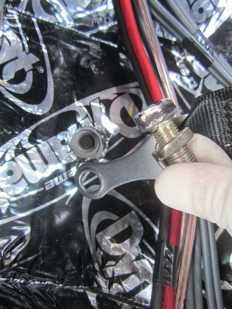

I decided to go with the Schroth Rallye 4 point harness.
After removing all the stock seat belts, I mounted the harness using the same bolts and holes.
