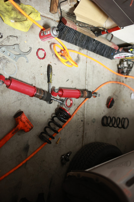

Some cheapo coilovers i got along with my s13 suspension! these are the rears that i disassembled to prep for install. They were basically free, and they fit the whole "ULTIMATE EBAY BUILD" vibe hahaha, so no plans on upgrading yet!
and before you say anything, YES I KNOW THEY RIDE LIKE SHIT! the car, IMHO is a piece of shit so it matches the vibe LOL

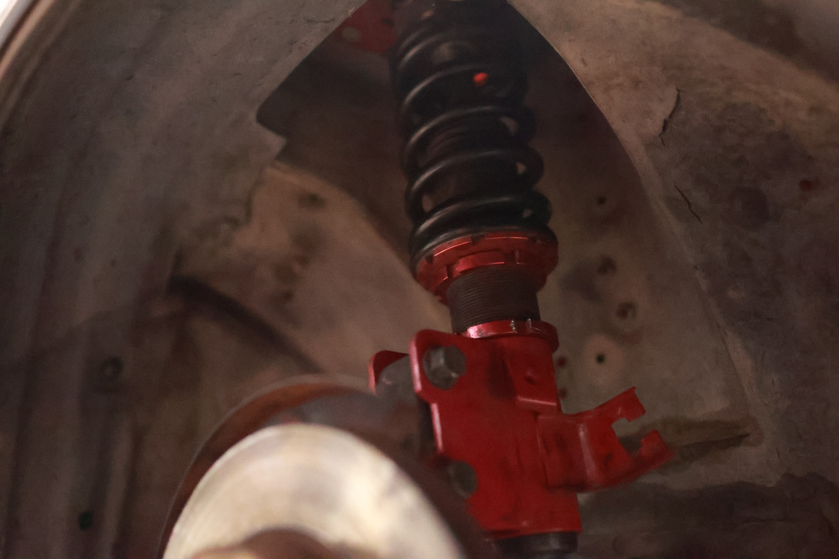

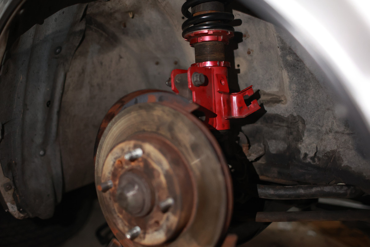

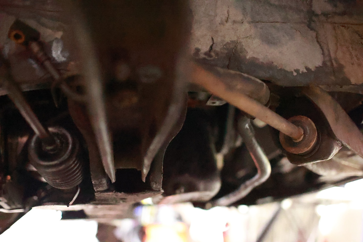

Pics of the front coilovers in!

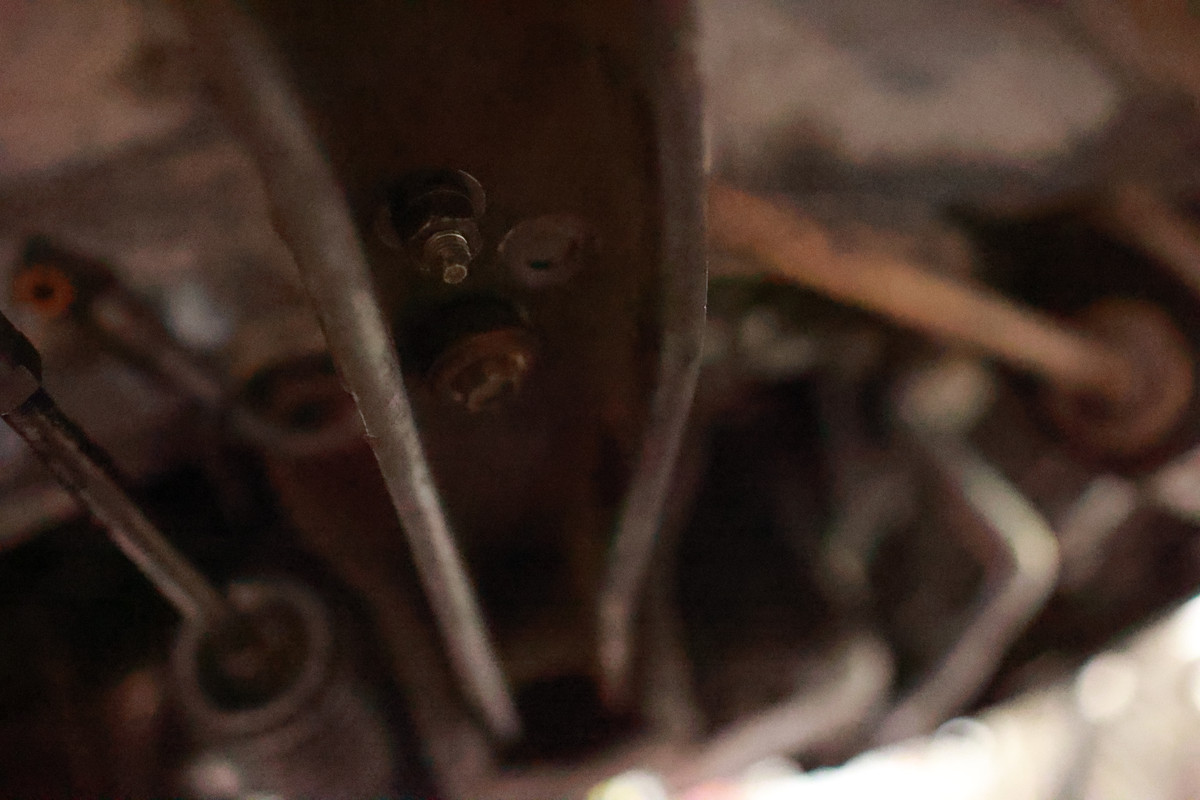

I was able to recycle the old tension rods by bolting them in with a single bolt on the arm. Tension rod brackets are tough to find, not to mention overpriced as shit. s14 tension rod brackets are VERY EXPENSIVE, so here's a solution for those of you who are penny pinching builders like me.
