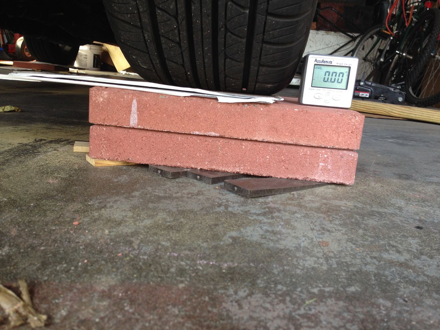

alignment update....i went through the sequence again to fine tune the measurements....this time i leveled the floor spots perfect, i used thick 1.5x12x12 garden pavers and wood shims...i also tried shimming the rear springs to reduce camber[top of fender arch to ground is 28"....much better results.
front driver camber 0*     toe in -.61mm
front pass camber  0*      toe in -.18mm
rear driver camber 0*      toe in -.23mm
rear pass camber .65*     toe in -.18mm
pix of tiles... saw these at Lowes and figured they are less likely to crack while shimming...very cheap as well. i still use the vinyl tiles on top to allow it to slide/settle the suspension.

Gotta hand it to you...precision is your game! I love the creative solutions you have to get the adjustments in there.
